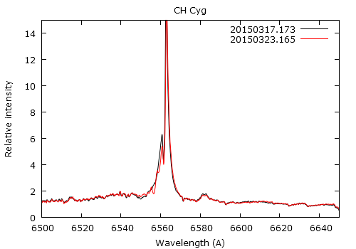

I had to wait for snow flurries to clear but I finally managed to get CH Cygni with my new 1800 lpm grating.
ISIS reports a resolution of 8898 so not quite 10,000, but good S/N.

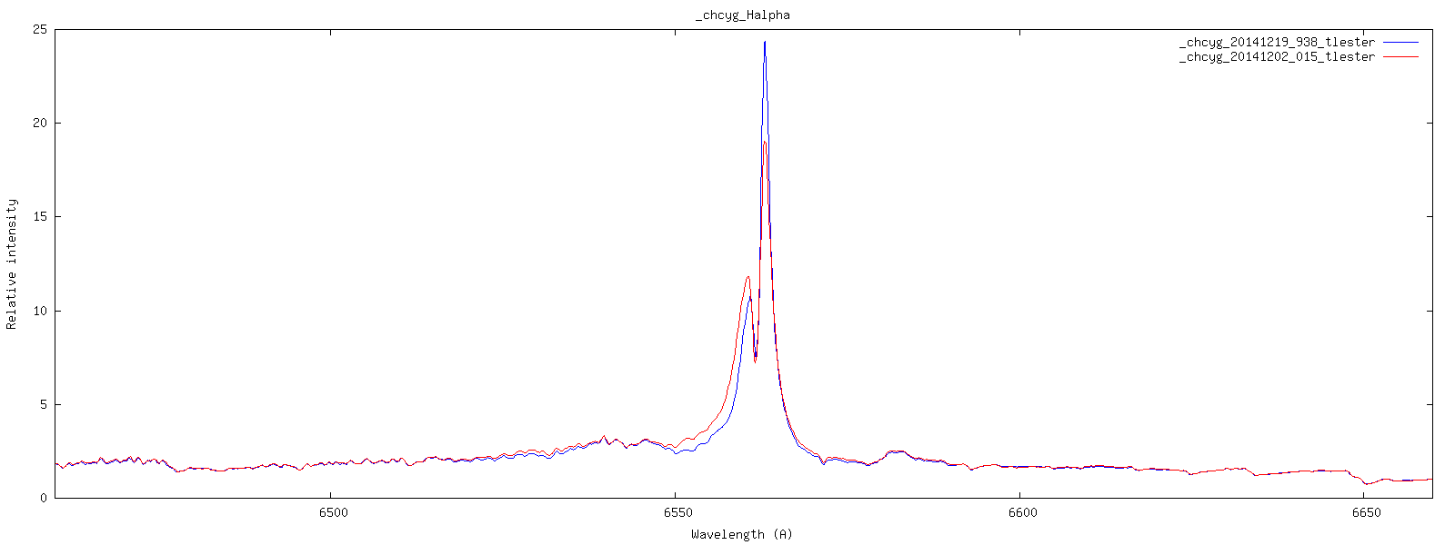

CH Cyg on Dec 19 - showing changes for Halpha since last observation on the 2nd.
Re: CH Cyg at high resolution
Hi tim,
Excellent spectra of red region!
(can you give more about your spectrograph setup : optical configuration, components, weight, images (?))
Hello Tim,
EXcellent. That perfectly responds to the request of Dr Skopal.
Of course, the fit is welcome in the database !

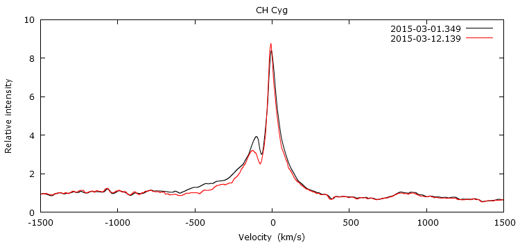

CH Cyg on Dec 28th - compared to my last two spectra.

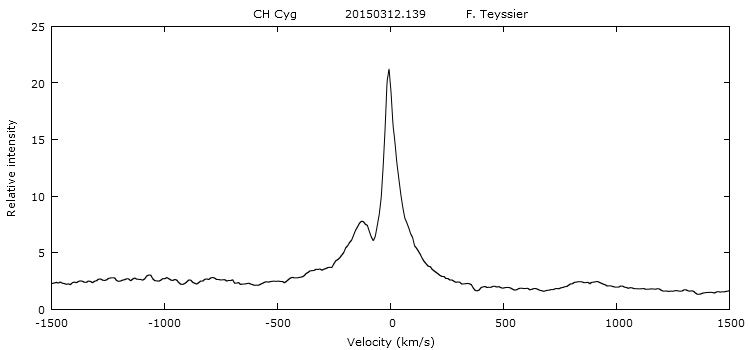

H alpha CH Cyg 10-03-2015
eShel + SC 10" + ATIK 460EX
Traitement : ISIS
Comparison with Tim Lester's spectrum
Rappel : H alpha campaign for Augustin Skopal : at least 1 spectrum a month
Low resolution spectra are welcome

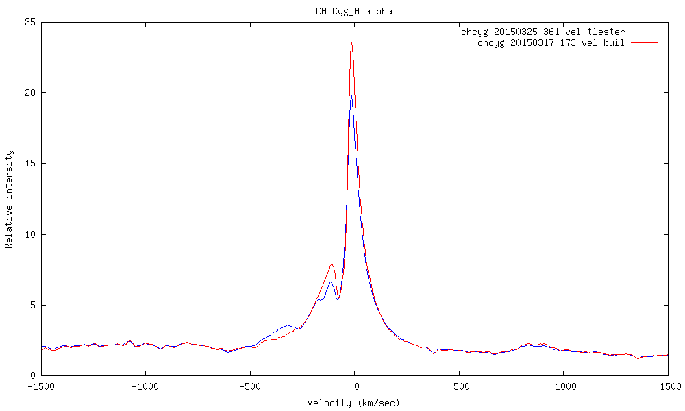

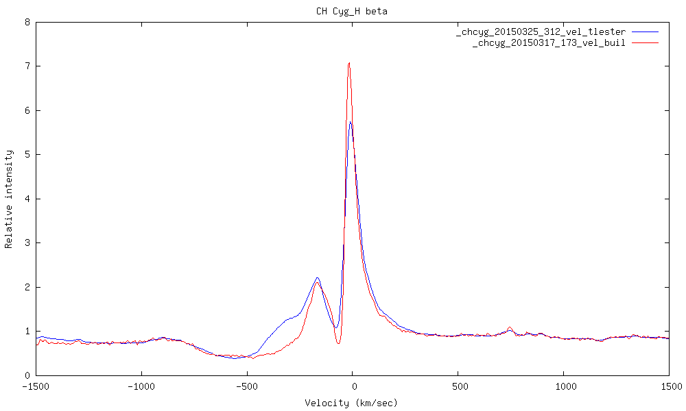

CH Cyg on 25-03-2015.
H alpha and H beta compared to Christian's last eShel spectrum on the 17th.
H alpha

H beta
Excellent !
The campaign begins well
There are several absorptions on the blue edge as your spectrum shows
Note : Augustin Skopal prefers that the spectra are corrected for heliocentric velocity
(I'll precise this point in the next letter)
