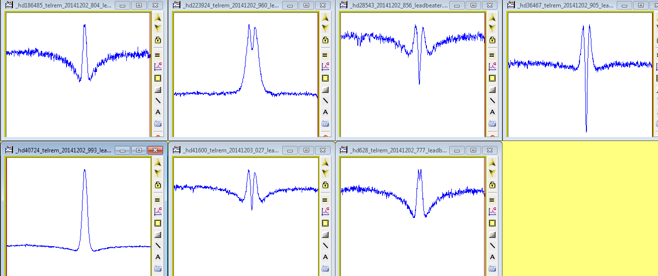

H alpha emission is confirmed at high resolution (R~16000) in the following APOGEE stars from this list
http://www.spectro-aras.com/forum/viewt ... f=32&t=948
ABE19 HD223924
ABE81 HD628
ABE100 HD36467
ABE112 HD28543
ABE146 HD41600
ABE147 HD186485
ABE170 HD40724
7 APOGEE Be Candidate stars at H alpha
Re: 7 APOGEE Be Candidate stars at H alpha

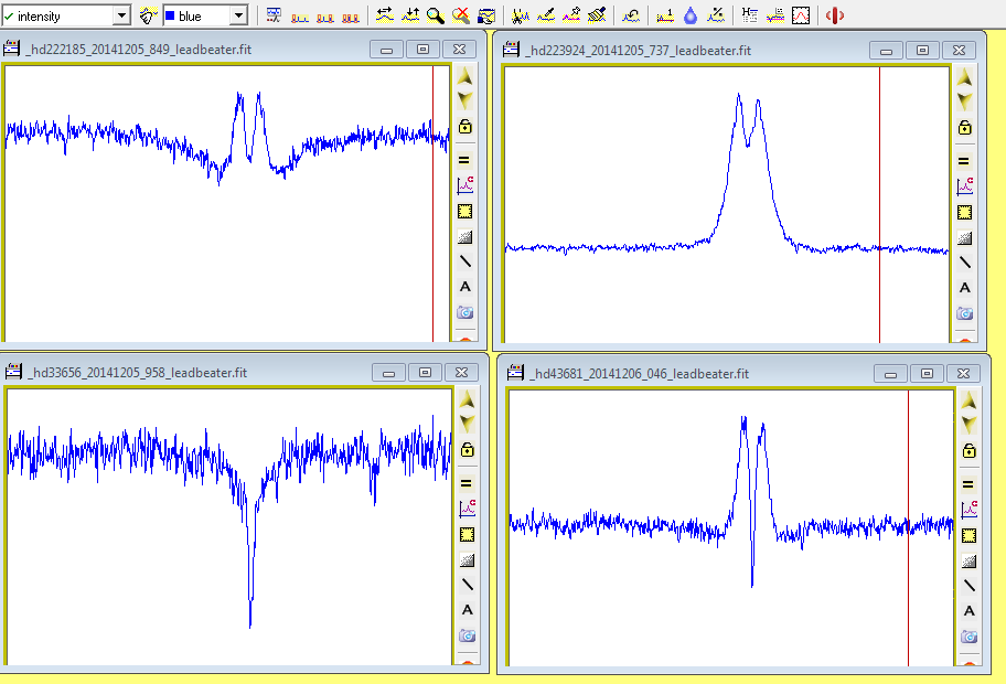

4 more APOGEE stars including 1 which does not appear to be in emission at H alpha currently
ABE19 HD223924
ABE30 HD43681
ABE156 HD222185
ABE176 HD33656 (not currently in emission)
ABE19 HD223924
ABE30 HD43681
ABE156 HD222185
- ABE_Be_candidates_20141205.png (29.12 KiB) Viewed 16228 times
