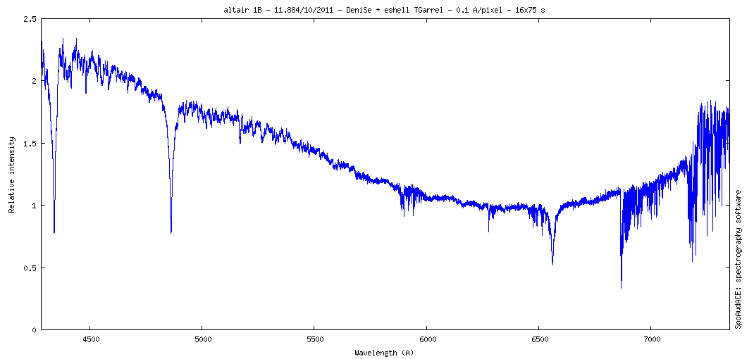

All image are processed with Audela, eshell module and Instrumental response was done with Vspec. I present here a 1B merged spectra of Altair. Note the absence of waves and ripples. A very clean continuum without high frequency artifact prove the very good geometric correction done by the eshell pipeline.
Alatir 1B
Alatir 1B

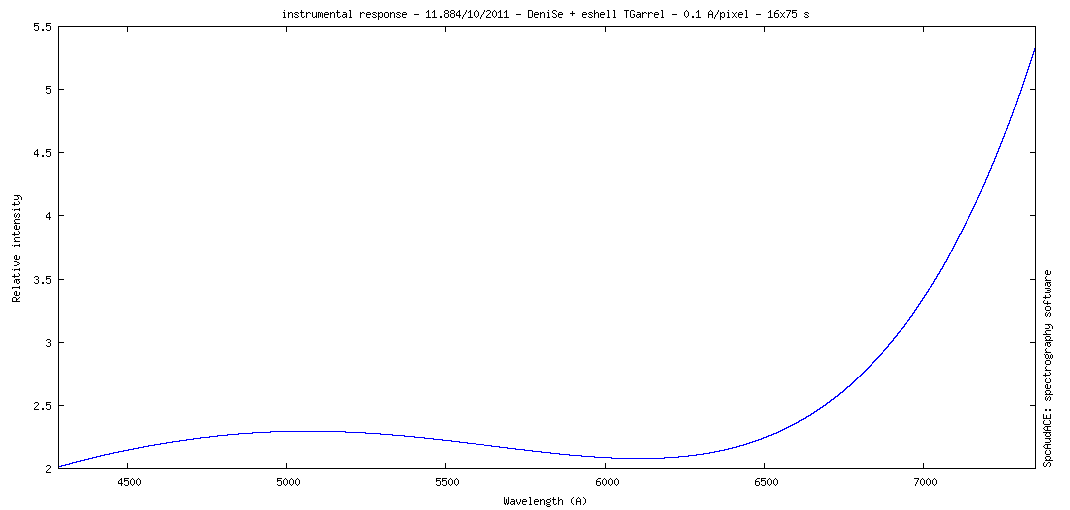

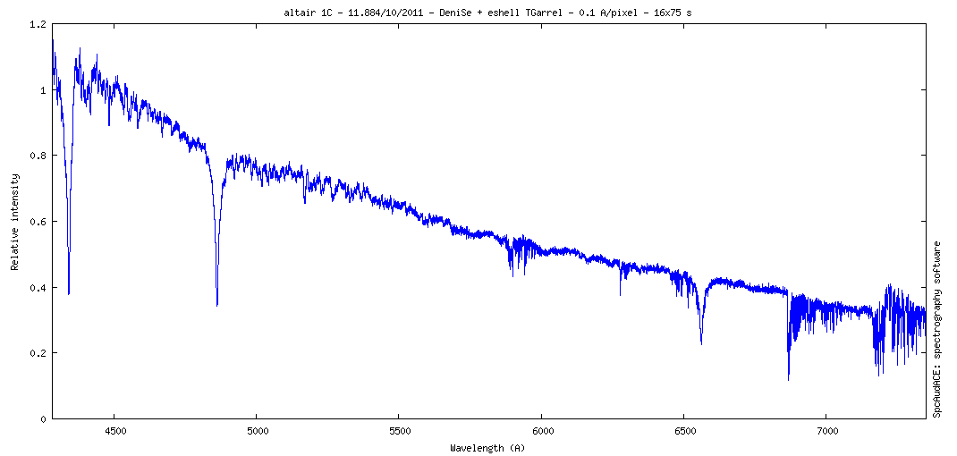

Only the overall shape have to be corrected by an instrumental response calculation done under Vspec. The result is a smooth instrumental response and 1c merged spectra proving the efficiency of the correction.
altair 1c
altair 1c
