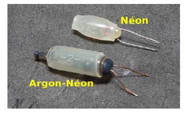

The manual for the upgrade show a translucent sleeve around the lamp. Does your's not have that?Mike Potter wrote: I noticed that the old lamp was wrapped in some sort of tape and maybe something similar should be done with the NeAr lamp - though I'm guessing that would absorb too much light and make calibration exposure much longer. Or maybe a reflective screen as is done with the flat lamp?
- LHIRES_new_lamp.jpg (12.83 KiB) Viewed 12241 times

Yes, the bulbs look exactly like the picture, but I can actually see the element through the translucent "wrapping". It does a good job of scattering the light along the entire slit, but at least in the position I currently have the bulb there is a section of each emission line that is a lot brighter than the rest of the line - which I suspect is due to the fact the slit is seeing the actual "glow element" through the translucent wrap.
