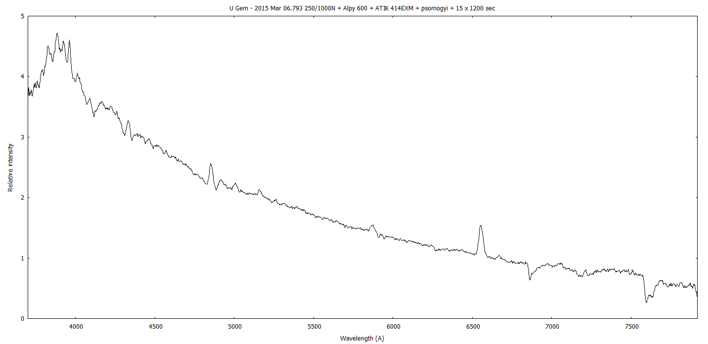

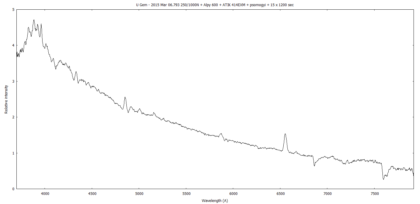

- Posts: 420
Re: U Gem in outburst
Nearly started before Francois's last spectra, a 5 hours exposure (with some technical breaks):
Animated gif of every 2 x 20 minute exposures - except last that was 3 x 20 min:
Ref. star was: 79-Gem, taken only 4 times (using averages in between).
Interesting to see the continuum temporary rise while Balmer remains almost there, showing other features.
