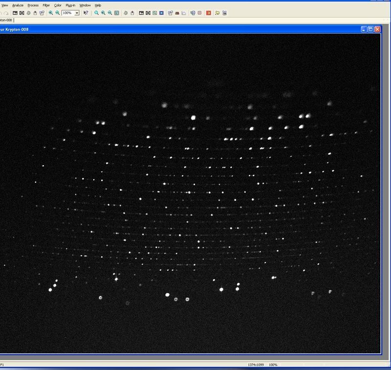

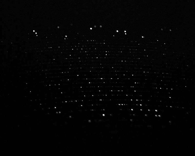

Voici ce que j'obtiens avec Maxim DL et le Thorium
Et cette même image du Thorium ouverte avec un autre soft que Maxim DL
Il y a donc un effet "miroir vertical" entre les 2.

OK, but, strangly I have had also to flip horizontally

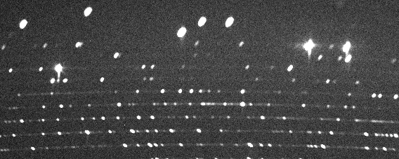

Here's the result in ISIS
I think it's OK ?

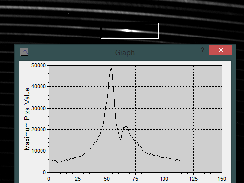

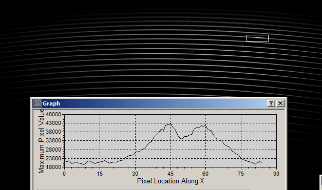

instead of flipping horizontally and vertically you can also rotate the camera by 180°, this should have the same effect. The image looks OK, but focusing can be improved as explained in my attached notes, which I wrote while setting up my echelle. They should apply as well to your echelle. In short if your collimator is not focused correctly the convergent beam on the grating produces astigmatism, visible as different slant of the ThAr lines in different orders. With correct focusing of the collimator (and camera lens) you will get nice round spectral lines :) .
Regards, Martin

Thank you Martin,
Impressive improvment
My work for next week-end
