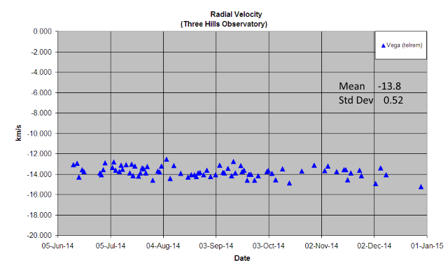

Here is my long term stability for Vega. Mean 13.8, SDev 0.52 km/s (Christian's eShel results on exoplanets were an order of magnitude better than this
LHIRES 2400, measured with ISIS using mean of 2 Si II lines at 6347.100 , 6371.360.
Calibrated with superimposed Ne/Ar lines from a Filly lamp mounted on the edge of the telescope aperture in line with the slit run during star exposures
- RV_Vega_LHIRES2400_THO.png (32.04 KiB) Viewed 10032 times

Thanks Robin, very helpful as always. I am making some progress with much better results from the simple procedure of bracketing a set of target images with calibration images. I have done a quick on-line search and found a number of sources of standard stars for RV measurement - some of which are bright enough for me to use practically.

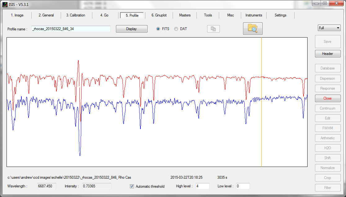

Robin - The attached shows one of my Rho Cas observations around Ha compared to one made bt Christian Buil in Sept 2010. I think the "Mirror Method could work well for complex lines like these allowing the red and blue shifted peaks to be both measured.
Regards Andrew
In my defense my observation had one half the exposure!

In cases like this I would say there is no single "right answer" for the radial velocity as the line shape represents an evolving distribution of velocities so cannot be adequately described by a single number. I think it is probably important to consider what is physically causing the line profile to change and how this relates to whatever property of the system you are attempting to measure. This can then guide you towards the most suitable parameter. (exoplanet measurements for example are ultimately limited by stellar pulsations which move and distort the lines). It can be useful to separate out the different components due to different physical phenomena eg the star photosphere absorption and the disc emission in the case of Be stars) There was recently a discussion on another forum as to how the expansion velocity of a Nova was derived from the P cygni profile. It turns out apparently that this is defined as the difference (in velocity) between the emission component maximum and the blue edge of the absorption component.Andrew Smith wrote: I agree the method of line determination may not matter too much as long as you are consistent for stable lines but not for ones that evolve with changing RV. I found this paper Comparison of Selected Methods for Radial. Velocity Measurements here http://journals.cambridge.org/download. ... c5c0bfb3b2 which describes a "Mirroring method" which while having a subjective element to it allows one to measure different aspect of a line (e.g. wings or core). Just need Christian to code it in to ISIS!
