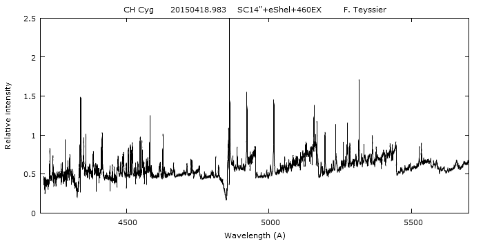

Symbiotics with eShel 18-04-2015

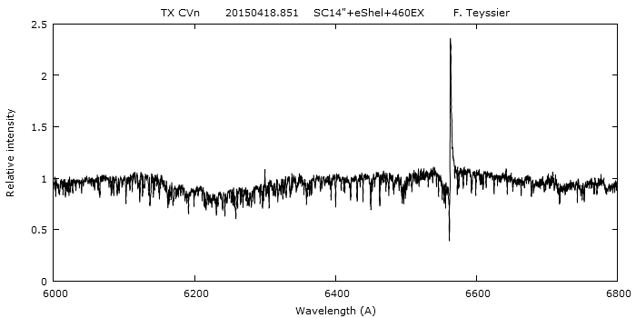

TX CVn Mag V = 9.8
[O I] faint in emission

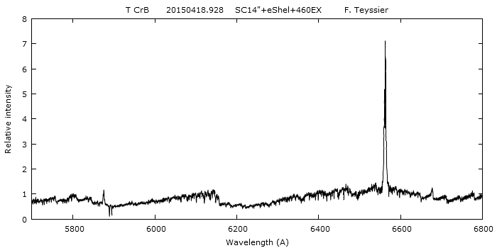

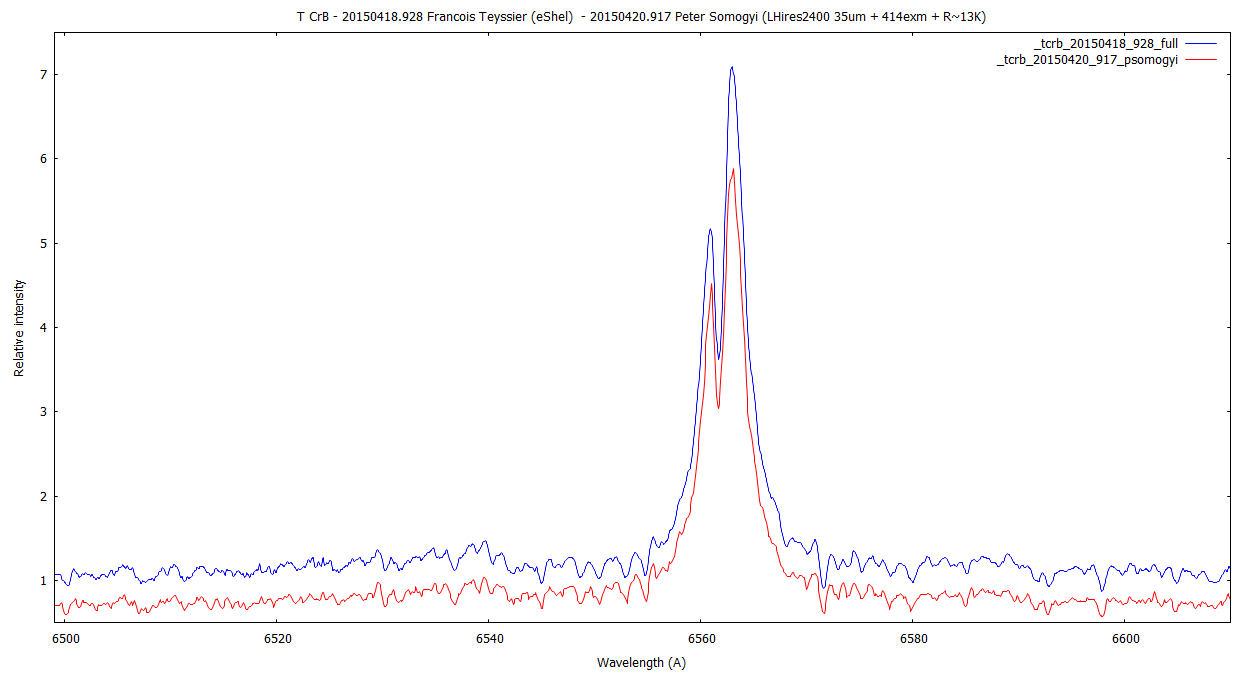

T CrB Mag V = 9.9

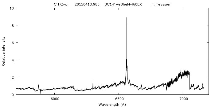

CH Cyg

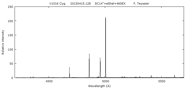

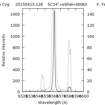

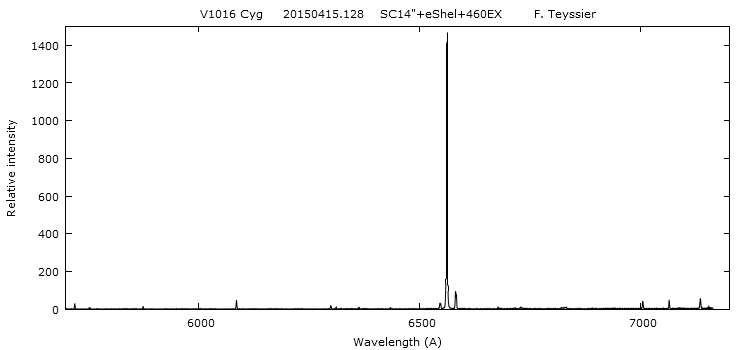

V1016 Cyg (Symbiotic nova) Mag Vis = 11 Mag V = 11.5

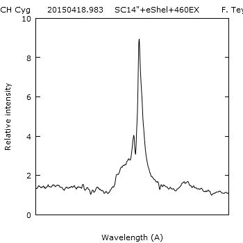

See the [NII] profile

Very nice spectra Francios! You have your eShel tuned up nicely. I am impressed with the S/N you are getting at this resolution (I assume you have some fiber coupling losses).
Everything must be well optimized plus excellent guiding. I have been downloading your spectra from the database to view them.
The graphs just can't do them justice.

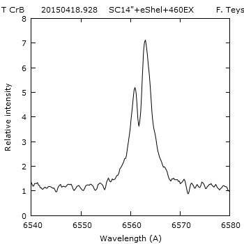

Re: Symbiotics with eShel 18-04-2015
T CrB with the same exposure time, switched to 35um slit (R~13K) and 2x2 bin, looks the small ripples on the continuum are also real:

Note that Peter got a correct spectrum of YY Her, very faint target, at R > 15000 (soon in the data base)
