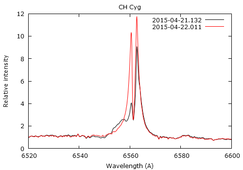

Dramatic change of H alpha profile
Campaign on the request of Dr Ausgustin Skopal
H alpha line at R > 10,000
and low res spectra
Posts: 1567
Red : Peter Somogyi Lhires III 2400 l/mm
Black : François Teyssier eShel
Only one day between the two spectra
The profile becomes again classical

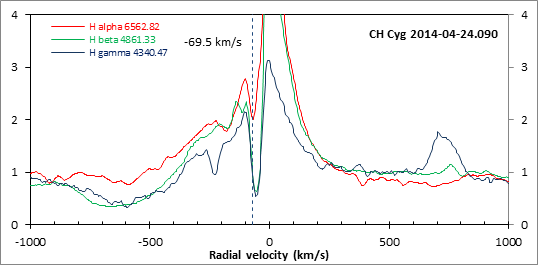

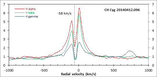

Balmer lines
12-04-2014
24-04-2015

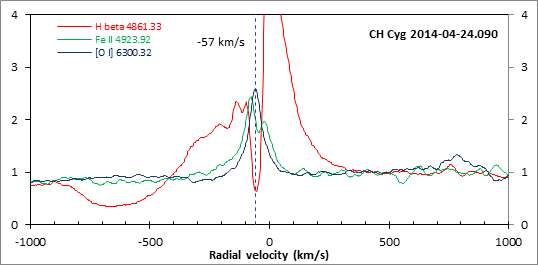

Comparison of the profiles of H beta, Fe II and [OI]

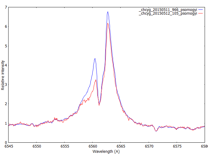

Following the recent alert from Peter, who observed the symbiotic during a relevant H-alpha profile change on 30 may, I took the spectrum on two night in which the change occurred.
This is the profiles (R~16000) comparison for 29 and 30 may (a behaviour similar to 21-22 april event):
I also detect a higher signal in the 30 may spectrum (~ 45K ADU of double peak maximum in single 600s exposure frames)
