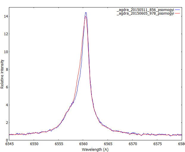

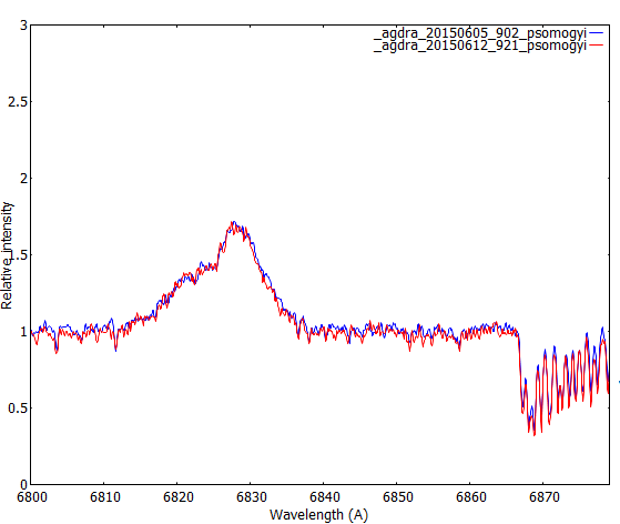

Hi all, yesterday observations (2 may).
H-alpha (R~16000):
Neutral helium and Raman lines (R~6000):
François, I'll send you all FITS profile.

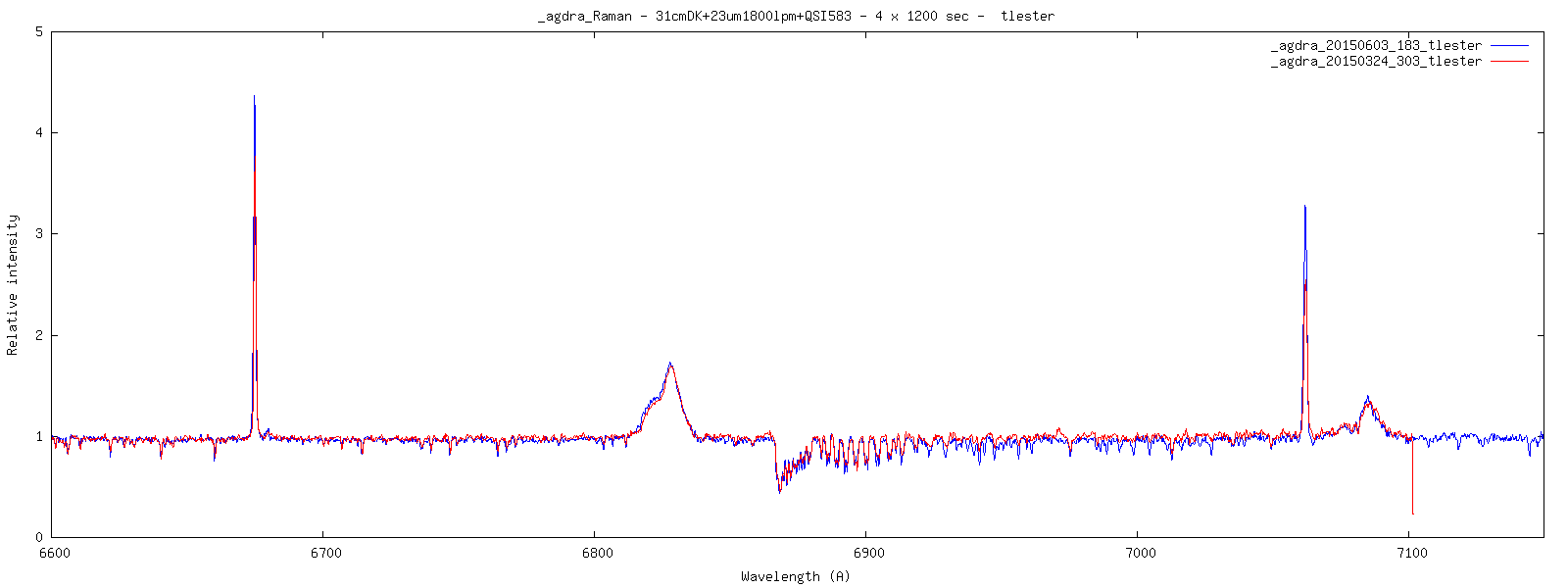

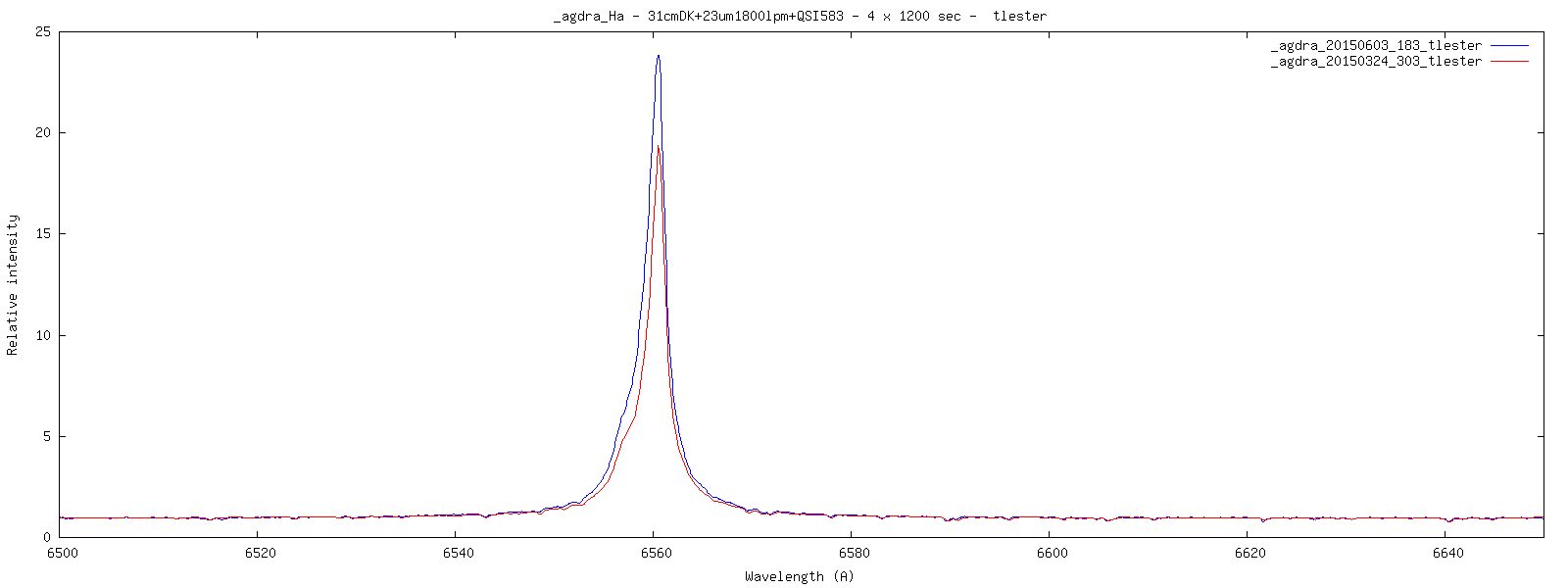

AG Dra for June 3rd compared to my last shot on March 24th (corrected for heliocentric radial velocity).

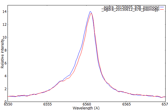

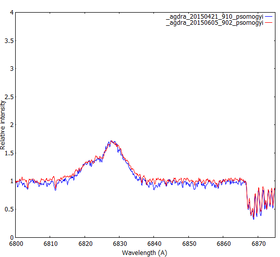

Re: AG Dra in outburst
Fresh material from the day before yesterday (25cm, LHires 2400/mm, 35um slit, 2x2 bin) compared to previous.
Minor H-alpha change:
Raman feature:
2 hours exposure in total.
Lots of telluric lines I guess (not removed), not just noise.
I don't see any real change.

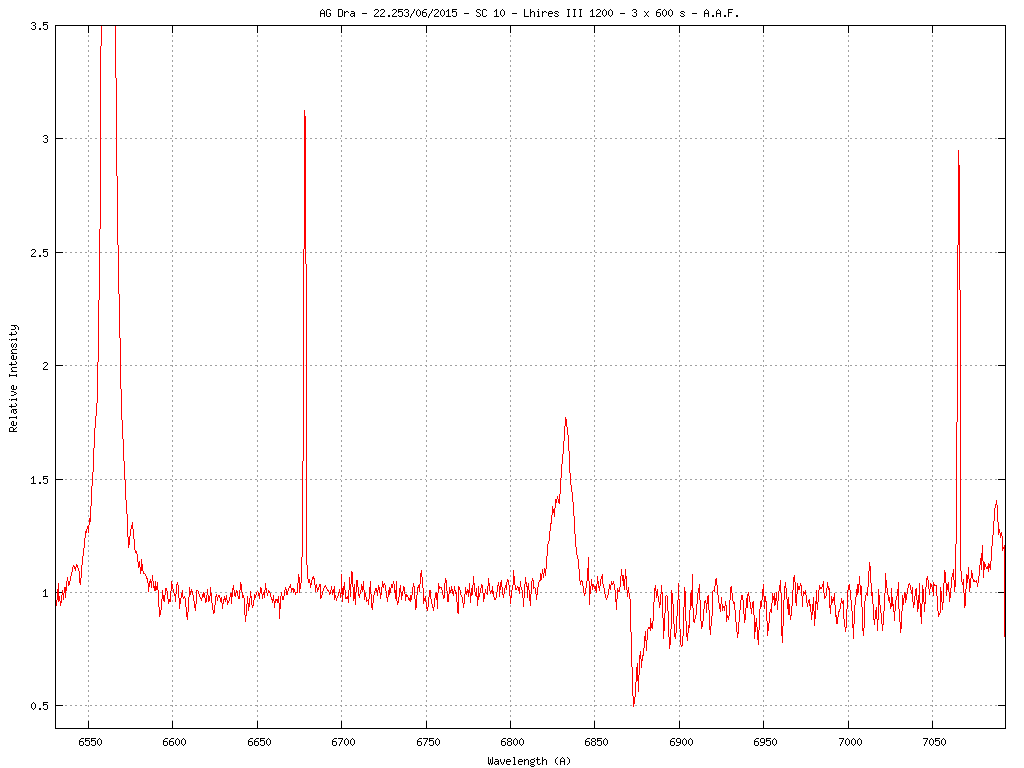

This is our AG Dra spectrum center on the Raman lines.
AG Dra - 20150606 -zoom- AAF.png (12.63 KiB) Viewed 8989 times
Nico
Associazione Astrofili Fiorentini

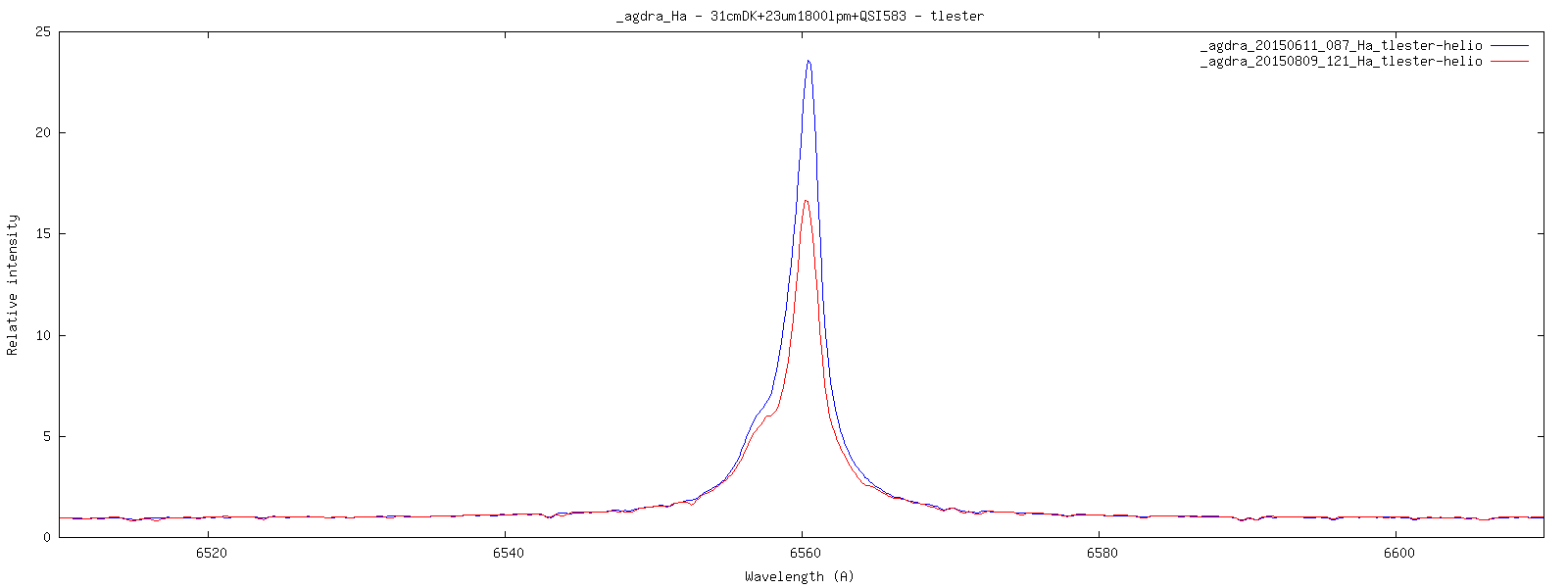

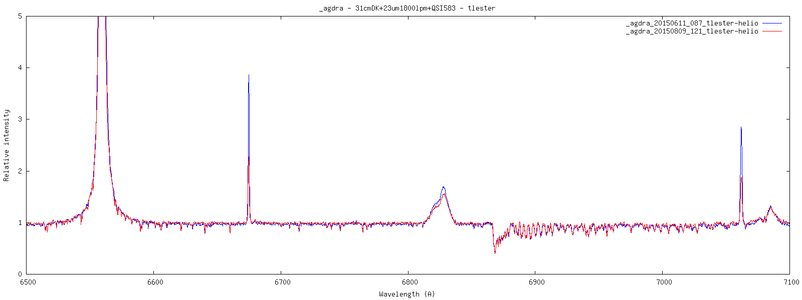

AG Dra for 2015-08-09 compared to my last result on 2015-06-11 (R=9000)
