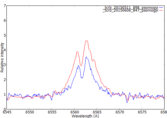

T CrB:
Slightly increased.

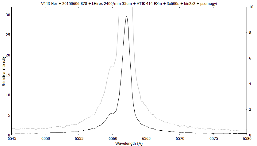

V443 Her:

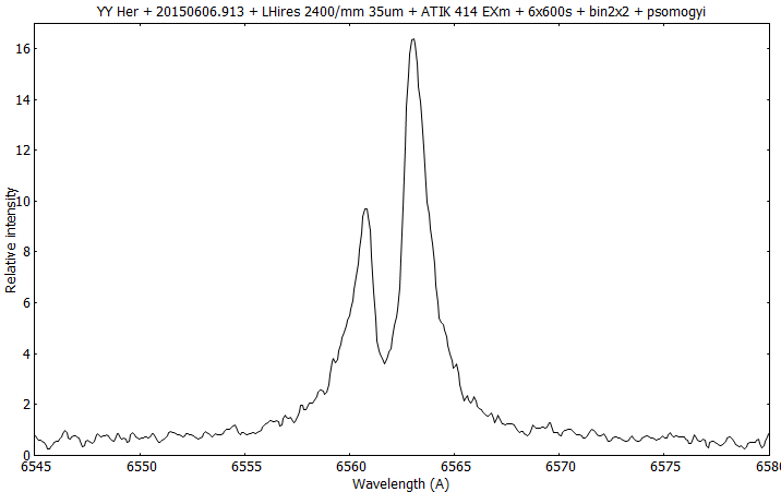

YY Her:
It was the hardest object, left peak increased a bit since last noisy exposure.

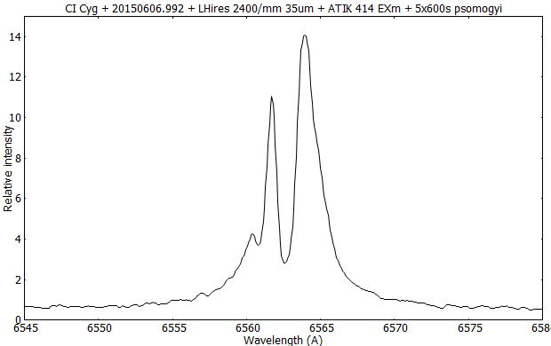

CI Cyg:
Having triple peak, good snr.

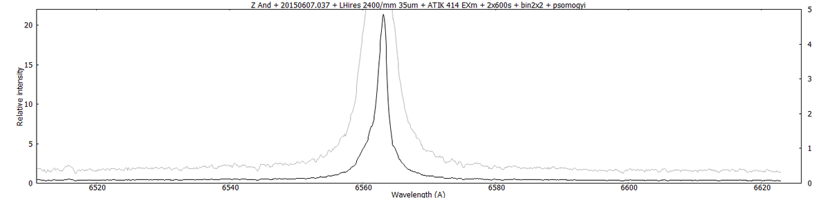

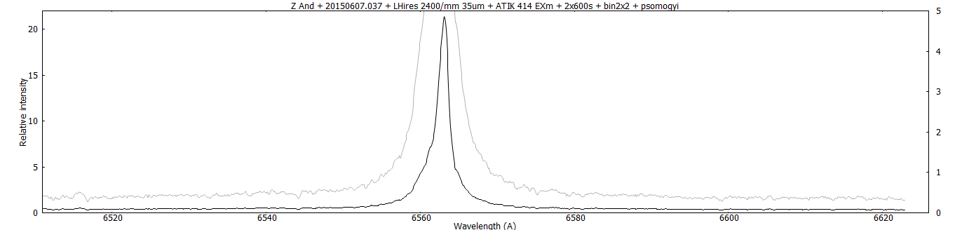

Z And:
Good snr, narrow and extreme strong H-alpha (increased a lot since last year).
