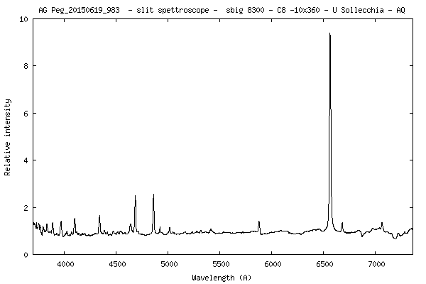

Salut, voici le profil de l'étoile, a eu une augmentation de la lumière.
La courbe classement AAVSO à 7,3 magnitude.
Profilo AG Peg.png (3.8 KiB) Viewed 7600 times
Cordialement Umberto

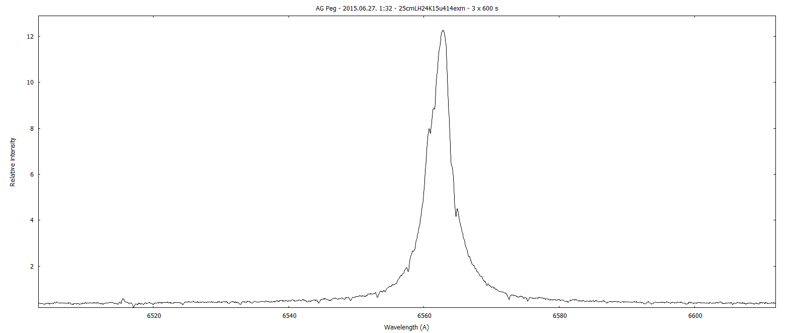

Re: AG Peg
Fresh H-alpha shape from yesterday (R~20K):
Interesting to be overplotted with BF Cyg, Ha-thickness is very similar (without deep outflow) and around 6515A(?) it is also having a sharp tiny feature (not a hotpixel !).
It was taken through thin veils so that H2O is very much present.
SNR is good, the 3 x 10 minute was needed only to have continuum also fine (and this was my final target). Someone might try short exposures.
Happy hunting!

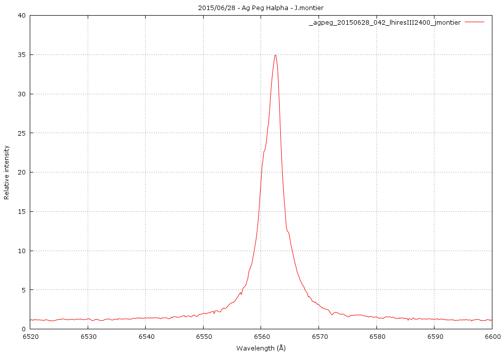

Here is the Ag Peg spectrum on 2015/06/28 with LhiresIII 2400 t/mm.
Apart the Halpha line, one can see the He I (6678 A) line.
Jacques Montier

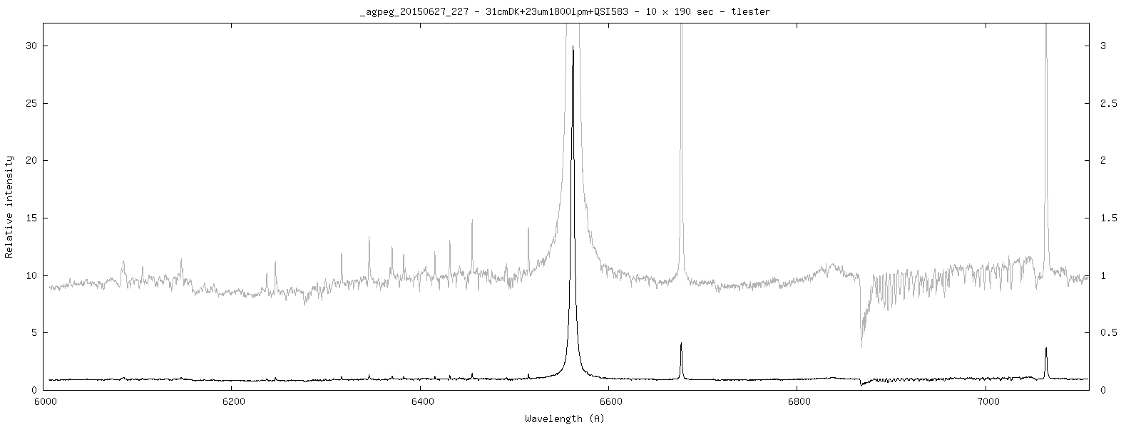

Re: AG Peg
Post by Tim Lester »

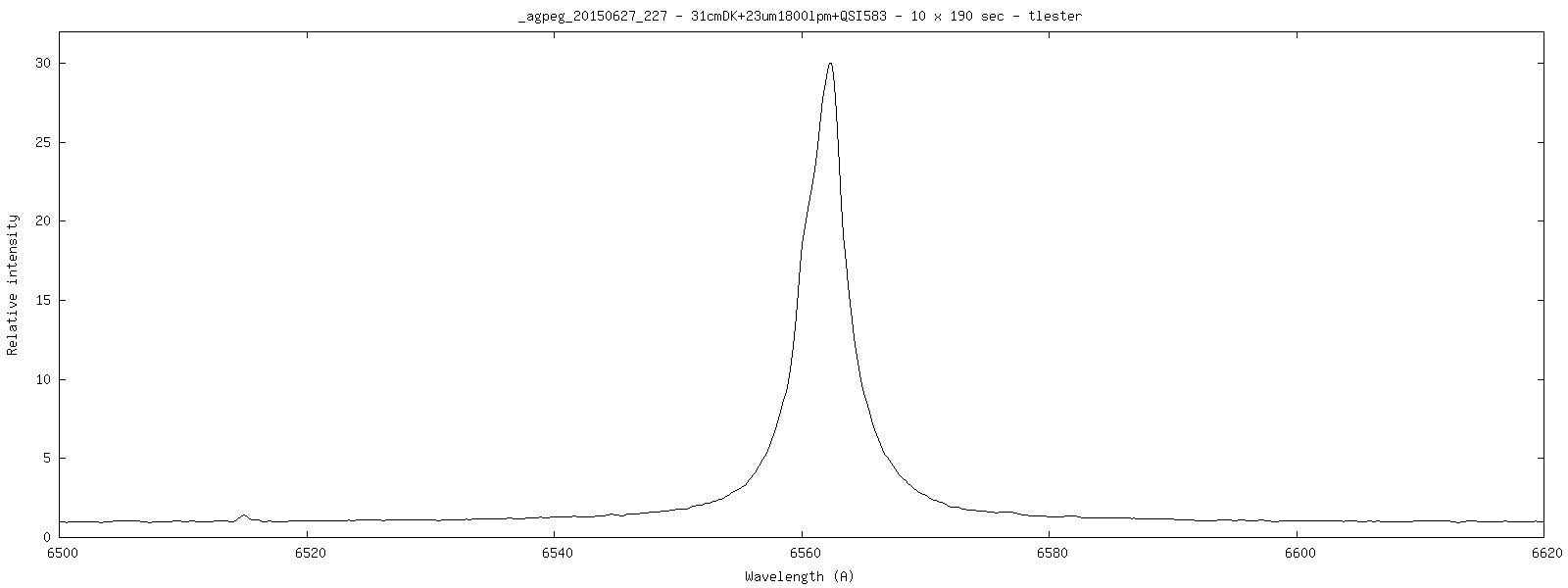

AG Peg for 2015-06-27 at a resolution of 9200.

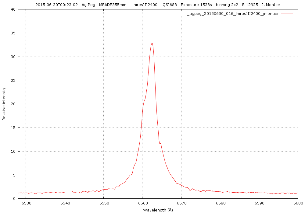

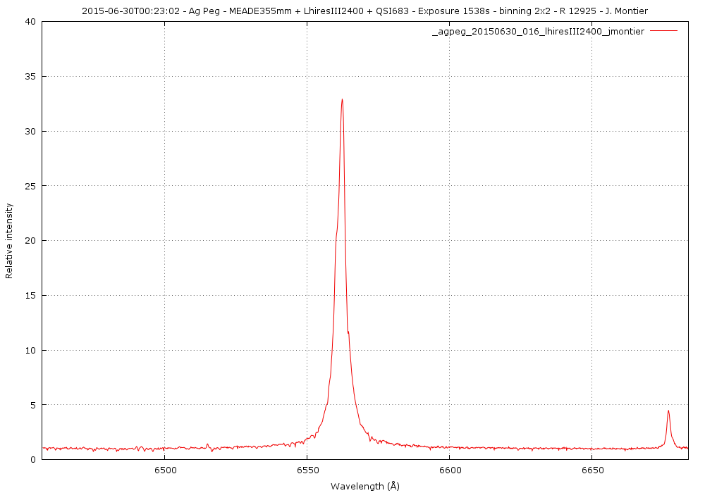

Ag Peg spectrum of the last night
Jacques Montier

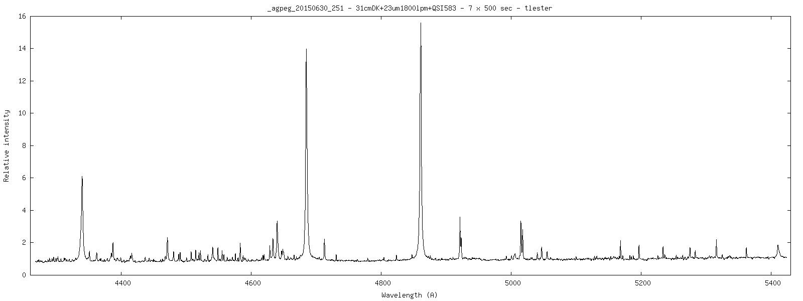

AG Peg around H beta on 2015-06-30 (R = 6350, S/N ~ 180)

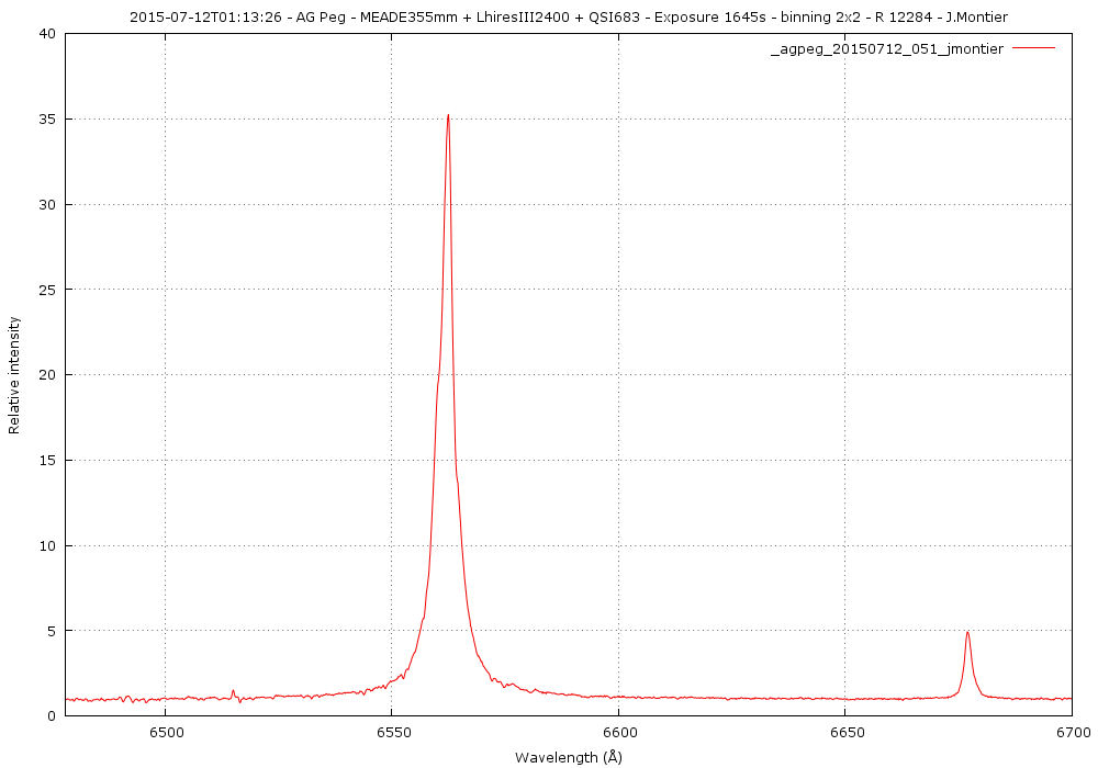

Post by Jacques Montier »

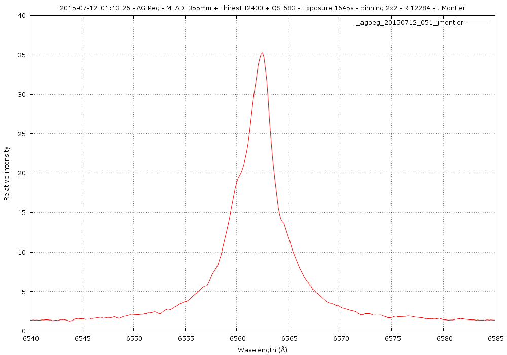

Here is AG Peg spectrum on 2015/07/12
Jacques Montier
