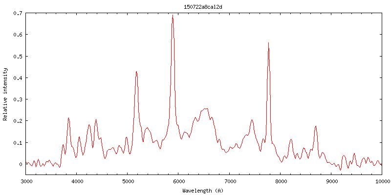

The results on the spectroscopy of this meteor and video spectrum you find further down on the page. I analyzed the beginning of the meteor spectrum by registering and stacking 8 video fields (160ms total exposure)
stacked spectrum of beginning

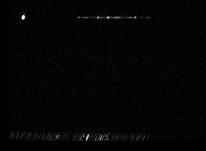

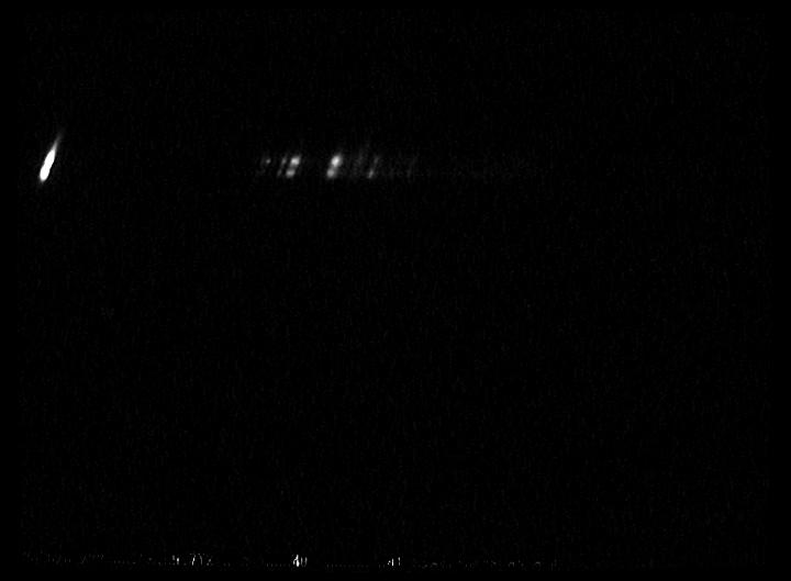

and the stationary afterglow by adding 7 video fields.
raw spectrum of trail

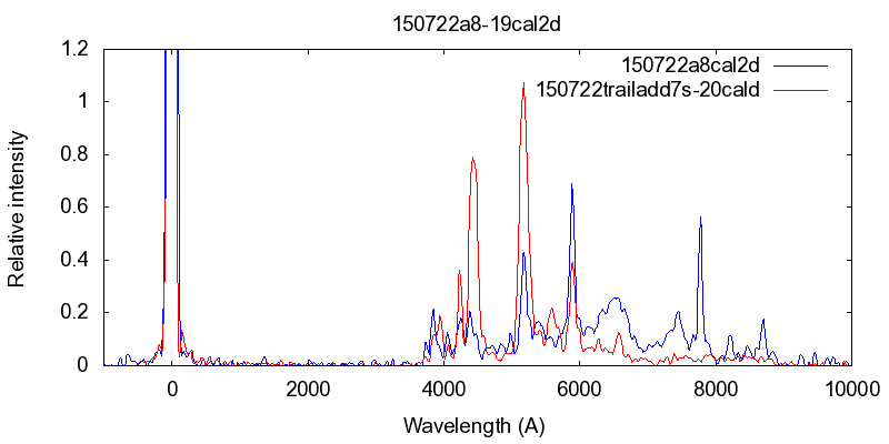

The analyzed spectra (not corrected for instrument response) show large differences, with the O I line at 7774A missing in the afterglow and the intensities of the Mg I (5178) and Na I (5890) reversed in the two spectra.

The forest of lines around 4000A has not been fully identified (Fe, Mg, Ca):
zoom on spectrum of beginning

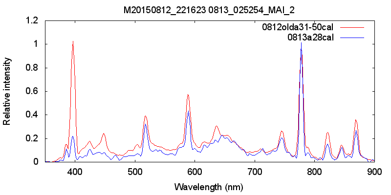

in the meantime some more spectra have beeen recorded of Perseids. The results are presented here:
http://www.meteorastronomie.ch/ergebnis ... ktroskopie
Here an example:
2 Perseid spectra during the night of Aug. 12/13
