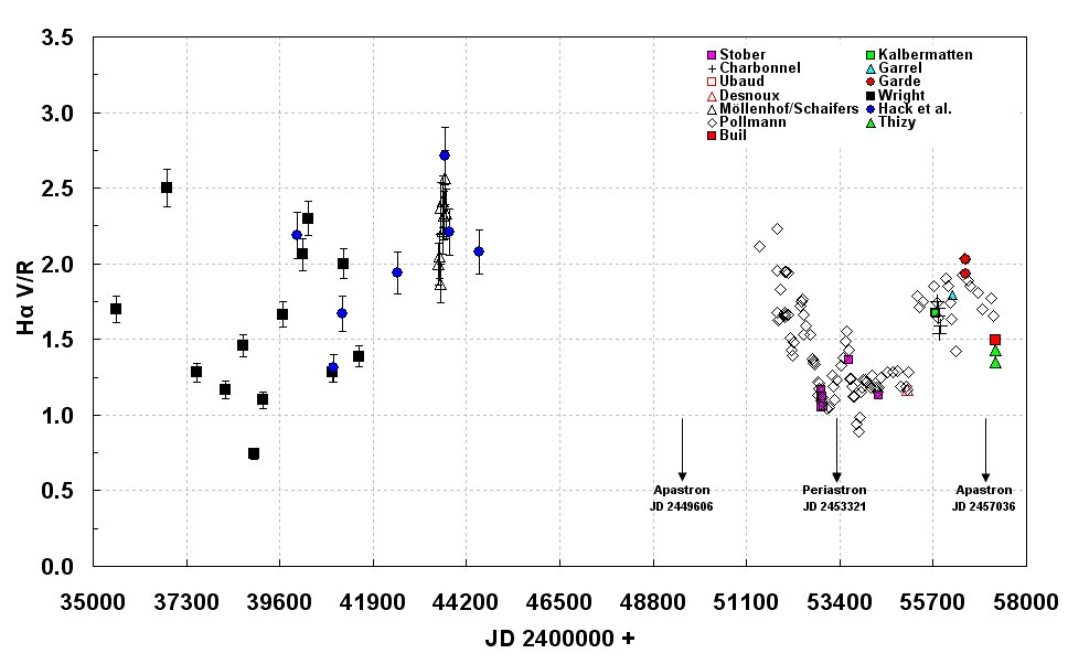

Re: VV Cep at R=50000 + ancient observations
Post by Ernst Pollmann »
Hi Christian,
here comes the evaluation of your current spectrum.
Ernst
Thanks Ernst!

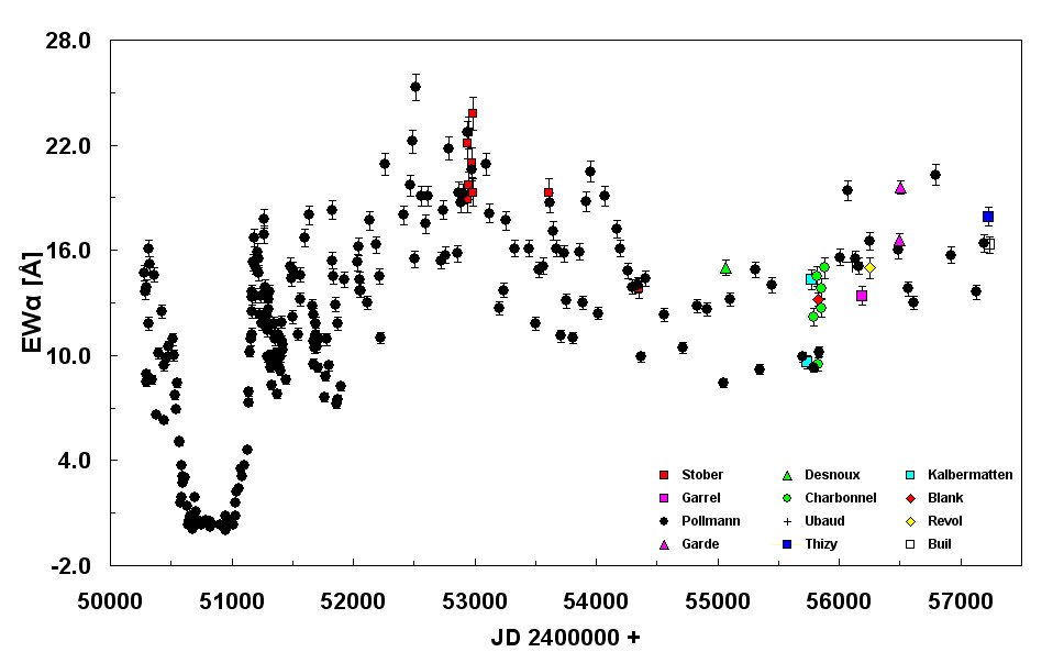

Hi Christian,
would you be so friendly to send your gamma Cas spectrum.
It might be helpful before the background, to clear the bump in the rise of the RV.
Ernst
