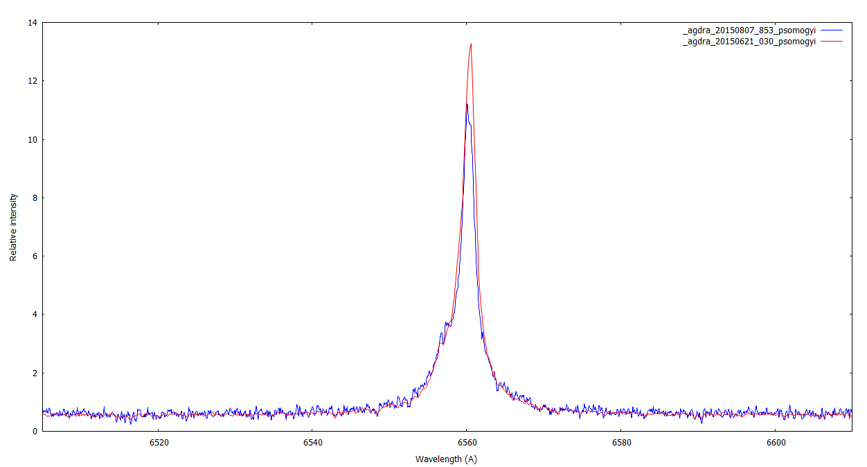

I think AG Dra H-alpha line is getting complex, I'd appreciate confirmation:
5 x 10 minute exposure, still noisy (unexpected to me) though I optimized focus and guiding.

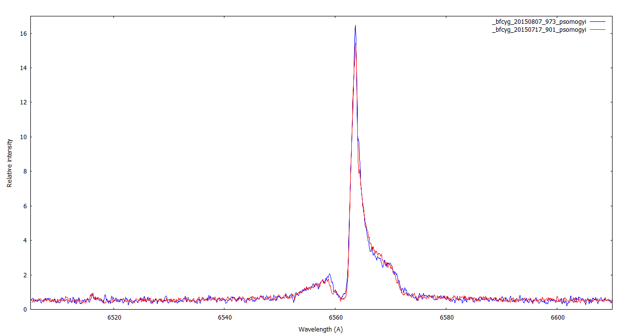

BF Cyg is slowly closing back, sharp edge U shape of absorption:
Last was 8 x 20 minute, an object that allows to sleep.

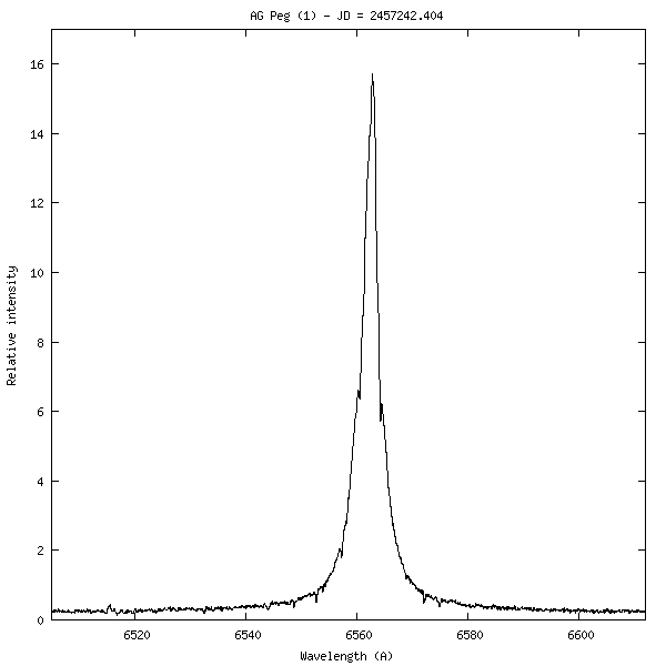

AG Peg, 10 x 3 exposure, I think the middle(!) of the H-alpha is showing a flicker, see this anim gif:

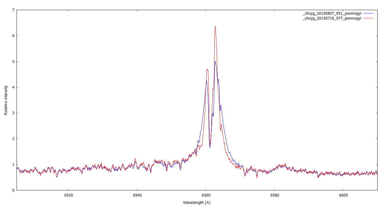

CH Cyg (3 x 5 minute):

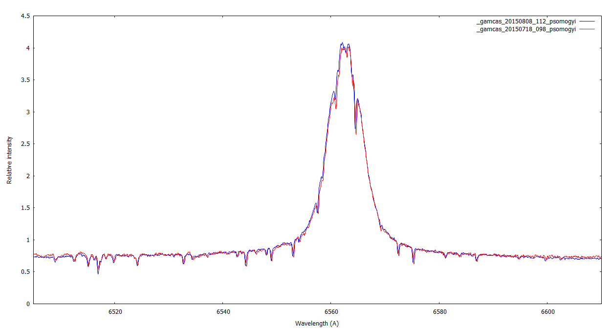

Gam Cas (11 x 15 sec):
Once I was trying to checkin this object to BeSS but failed, I must invest more time on docs how to do it.
