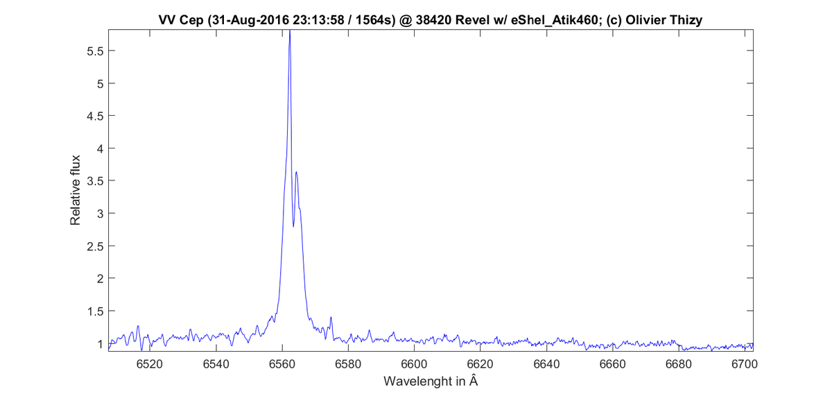

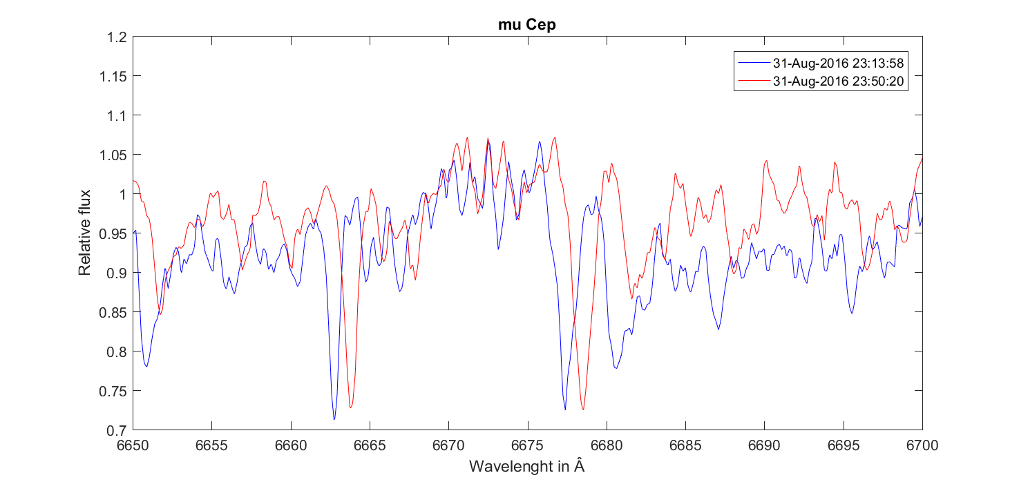

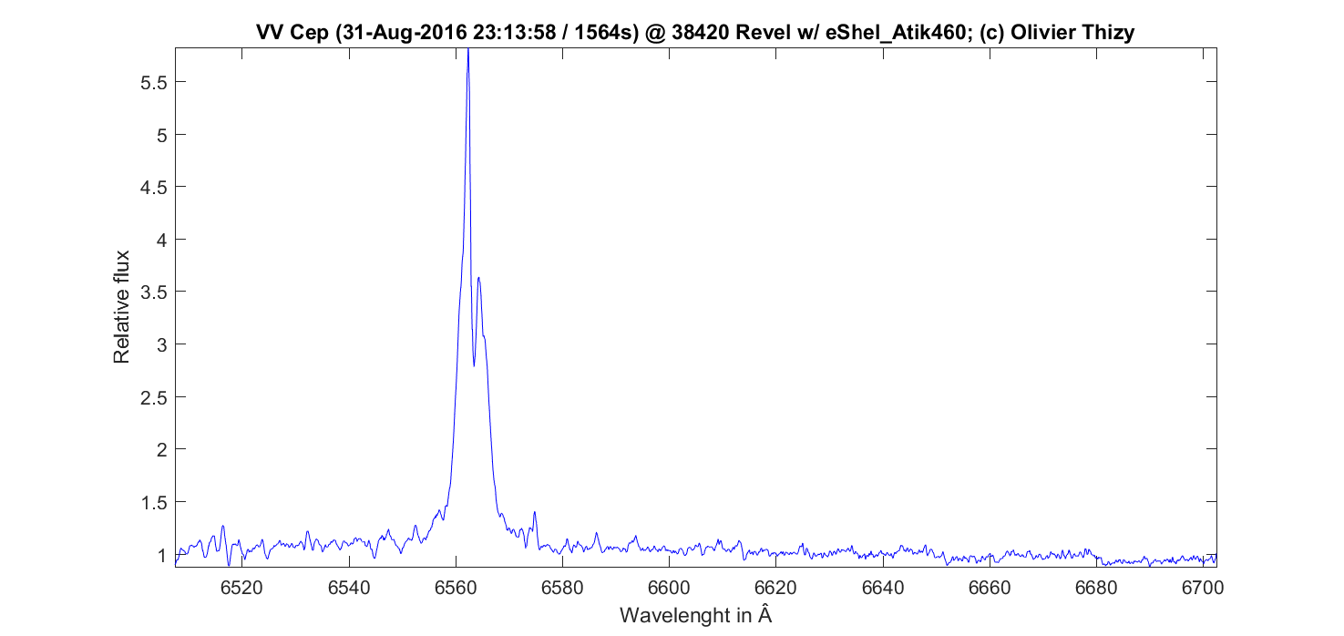

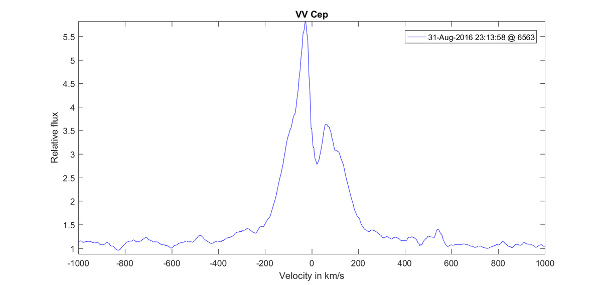

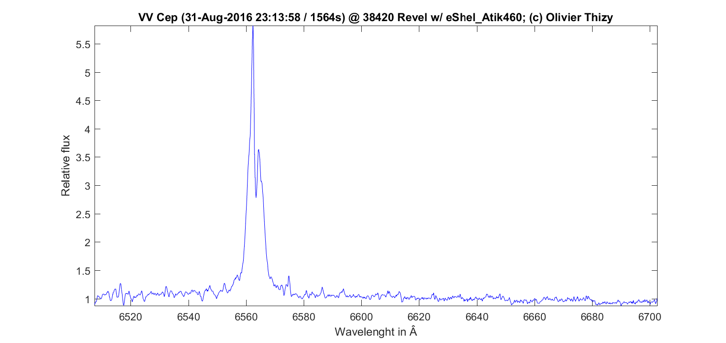

two nights ago I took a spectrum of VV Cep and mu Cep in order to compare them.
Around Halpha for exemple, the spectra look very similar with a shift of 48km/s (CDS Simbad gives a difference of 23km/s + 18.7km/s so 41.7km/s; I suspect the additional 6.3km/s are actually the RV of the super giant as binary companion).

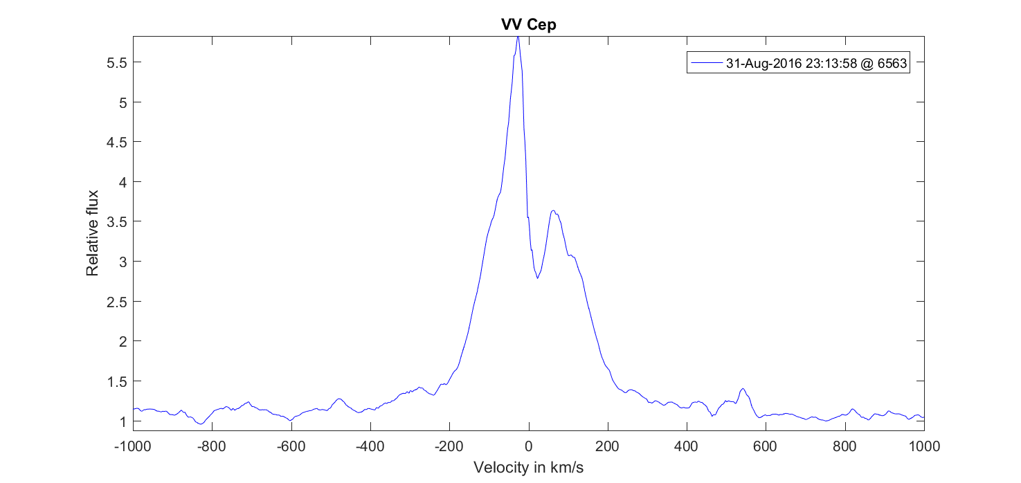

I divided the two spectra and obtained what seems the Be emission:
In velocity around Halpha:
I am not sure if this division means anything or just imagination (!), but is this is the emission of the B star alone (maybe with some absorption from the B star?), what is the meaning of measuring the RV of the central line?
If this is the combination of emissions from a disk with two peaks (typical in Be stars), the distance between the two peaks and the R/V ratio (after removing the M star component, at least roughly) would be a more traditional way to lok at emission, no?

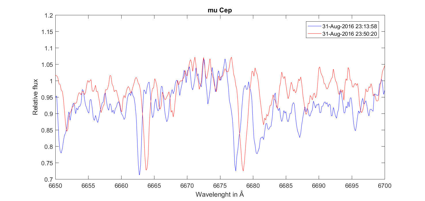

A side question as I look more closely to VV Cep spectrum. I thought the line which seems broader at 6678 was He I of the Be star; but the same feature is on mu Cep spectrum so I guess now that this is only the M star spectrum. Here is a comparison of VV Cep and mu Cep in this area:
Is there any 'non emission' line in the VV Cep spectrum which comes from the B star and not the super giant? This would be a good candidate to monitor RV, no?

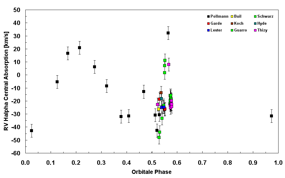

Once again back to the radial velocity of the Halpha central absorption.
I found at Kawabata et al. (Publ. Astron. Soc. Japan, 33, 1981) the following statement:
The variation (displacement) of the radial velocities of the Halpha central absorption may be due to the HI gas (= cloud around the whole system) which expands with velocities of 10-20 km/s to us.
But I don't think that this explains the much higher variation in our observation.
Ernst

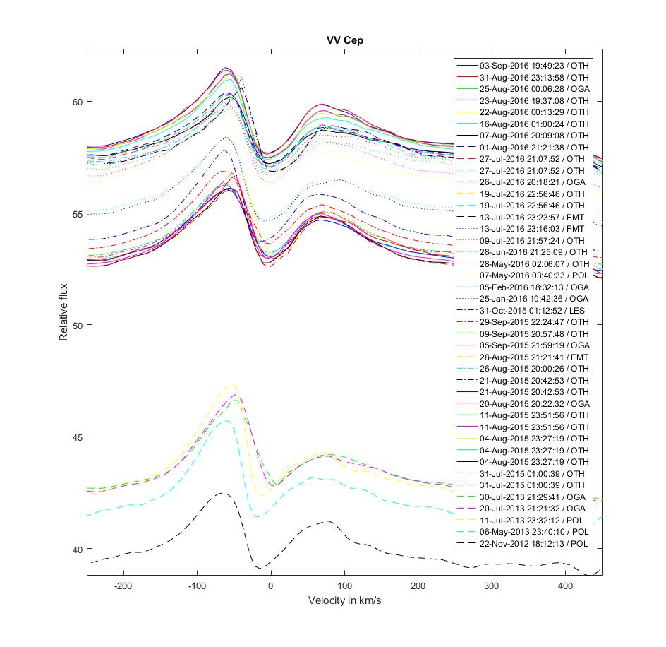

thanks! Using the same ephemeris JD 2438481 + 7430 x E0 (Wright, R.A.S.C. Jour., Vol 71, 1977) - it helps when talking about phase 0.5! -, I plotted this graph with the high resolution (mainly echelle with some additional others to fill the gaps) spectra from current ARAS database:
Phased (Epoch-Period) graph VV Cep.jpg (118.36 KiB) Viewed 19939 times
For my reference, my command line:
Code: Select all
otz_plot -250 450 'all' -w Ha -y p 100 2438481 7430 -x RVH -s 6582 6584 -p pdf
The spectra are distributed on the Y axis as per the phase *100 (ie: spectrum with continuum at 50 is phase 0.5). The spectra have also been corrected from VV Cep published RV (-18.7 from CDS) as well as heliocentric radial velocity correction based on FITS header data.
Anyway, I am trying to match your RV graph of Halpha central absorption with that one... A surface plot (2D time phased spectrogram) would be better but I haven't figured how to do it yet.

Olivier,
For my understanding your plot shows mostly the same variation in RV, however with a somewhat lower resolution in velocity.
But my main problem is still to understand, how and why the "Hydrogen cloud around the system" (that is producing the central absorption in Halpha), varies in RV depending on the orbital phase at all.
