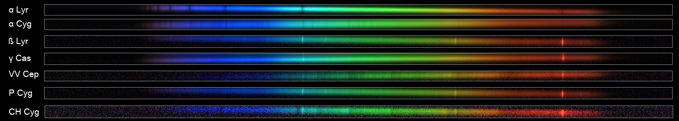

At the OHP I was able to get some nice spectra of VV Cep. Having an image at hand, probably helps to follow the discussion about spectral profiles of VV Cep, beta Lyr (shelyak), etc. So, I created a simple mount of certain raw stellar spectra, that I’ve taken at the OHP with my Vixen 8“ Cassegrain, Alpy 600 and modified Canon EOS 60D DSLR with Astronomik UV/IR L-Filter. Although, wavelength range is uncalibrated, Balmer lines of alpha Lyr will yield good watermarks for typical wavelengths of spectral properties.
This is an invite to discuss (and correct me, if I'm wrong, of course)!
From comparison of these stars, some of them Be stars, like Sheliak, VV Cep yields very confusing aspects from having a first look onto stellar spectrum obtained:
  • Prominent emission lines
  • No He emission
  • Very low UV excess at Balmer lines below H-gamma (434 nm)
This is just what was my first impression: Hohle et al. (2010) reported spectral type M2epIa and 64 solar masses for the prominent red supergiant and B8Ve/B9 and 35 solar masses for the hot companion. Although, late spectral type Be might be thought and indicated by emission lines, it seems more likely, that the companion is not a Be star. Also note the missing He emission line compared to beta Lyr, P Cyg and CH Cyg, which also has an M type primary.

From my spectrum, however, it is very impressive, how faint the blue and UV part of the spectrum (below 434 nm) really is. In this wavelength range one should expect the maximum of light of the hot companion. Please consider, the image intensities are already enhanced by amplifying low image intensities using a square-root like intensity correction. Thus, taking into account a difference in luminosity (apparent magnitude) the companion should show up a little brighter, like CH Cyg. Of course, this is not absolutely correct, when talking about "luminosity" or "bolometric magnitude" vs. absolute (or apparent) magnitudes of the two binary components of VV Cep. But, taking into account, that a hot star shows a more blue compressed spectrum, the blue part from the hot companion of type B should show up a little brighter compared to the broad M spectrum. To evaluate this, look how different spectra of an A type spectrum of alpha Lyr look compared to VV Cep or CH Cyg. Nevertheless, even after amplification of the spectral intensities the blue part of the spectrum of VV Cep remains "dark". Please correct me, if I'm wrong here.

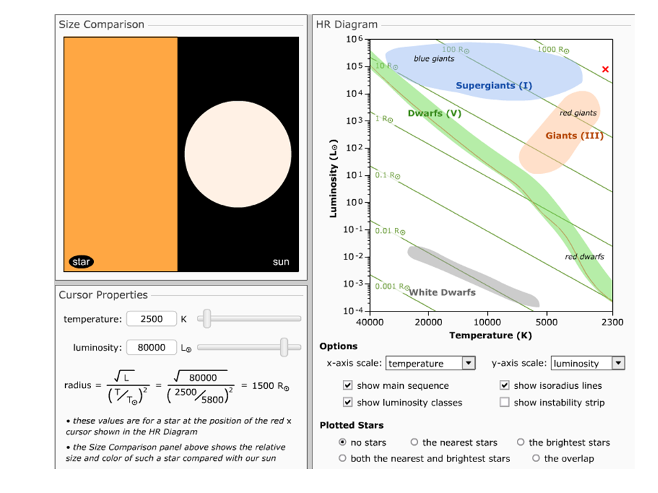

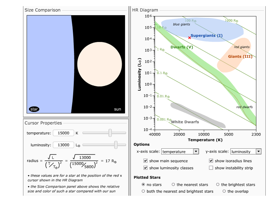

To get an overview of the differences in brightness of both components, I used my own (Wuppertal-seminar) tool (see attachments), in order to "play" with the radii, masses, and temperature references we found in the literature (see my distributed pdf-paper, written by Ph. Bennet, J. Hopkins and me).
For the primary I used (the following averages):
- 1500 solar radius
- 19 solar masses
- 2500 K
for the companion (the following averages):
- 17 solar radius
- 16 solar masses
- 15000 K
The use of these average parameters did lead to the following luminosities:
Primary = 80000 solar luminosity
Secondary = 13000 solar luminosity
By using of delta mag = -2.5 * lg (80000/13000), the brightness difference between the both stars is 1.97 mag. This "small" difference contradicts the difficulties in identification the spectrum of the companion.
