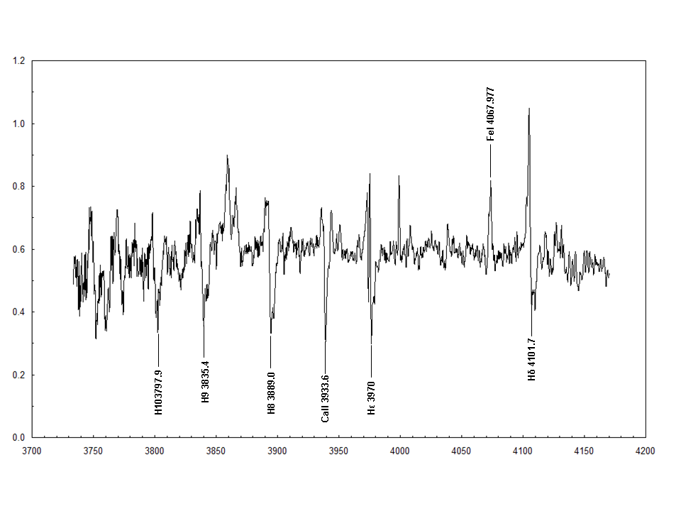

Hi Thilo, thank you for the answer. This is the first time I observe VV Cep. Surely it's not easy for me to decipher the spectrum...
I just try to rescale the mu Cep spectrum (the star I observed yesterday as advised by Ernst) to approximately matching the VV Cep cold star spectral features (in the 4000-4100A interval):
then I subtract it from VV Cep spectrum:
The result shows some emission lines and reverse P-cygni for Balmer lines with a complex profile on H-epsilon and Ca II H lines (around 3970A). I don't know how much of this is real and what might be artifacts.
Please note that the spectrum is properly focused only in the central part (for chromatic aberration of spectrograph doublet).
The comparisons between two-dimensional spectra of VV Cep and mu Cep (central part of spectrum):

Dear Paolo,
thanks for sending me your subtraction spectrum.
After a rough line identification, I re-calibrated the spectrum with the labeled lines and its wavelengths. The calibration accuracy (RMS) has been (+/-) 0.35 Angstr./pix.
It seems, that you has been able to "isolate" several members of the higher Balmer sequence. But the quetion is, whether these lines are coming from the B component, or still from the accretion disk.
Nevertheless, with this sort of subtraction spectra it will be possible along with Hbeta and Halpha, to observe the temporal sequence of the eclipse.
Ernst

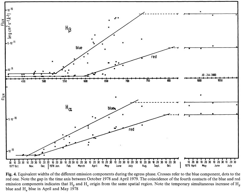

Dear Paolo,
as addition here in instructive plot of Möllenhoff & Schaifers (A&A, 94, 333-337) of the 1976-78 eclipse.
Ernst
