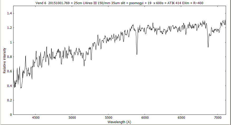

After my 1st attempt (cloudy 3 x 10min) now I have a 2nd attempt at ideal conditions with 19 x 10 min (this gave me the chance to exercise my 150/mm grating with the LHires III for the first time - exploring the limits with the 35um slit).
Result:
(I think at the very blue the emission-like features must be just noise. The LHires also doesn't seem to be usable below 420nm - too narrow region to focus by the doublet - applying the 150/mm grating.)
Unfortunately no emission - so the pressure of higher SNR is demanding, especially in blue.

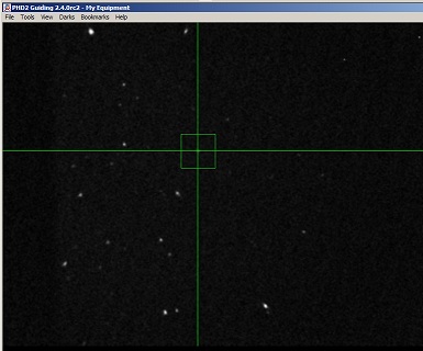

Guide view:

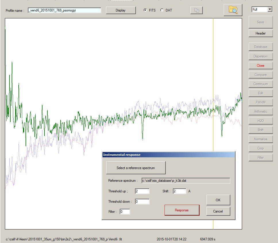

Best fit:

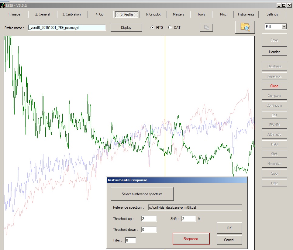

To confirm not an M type:

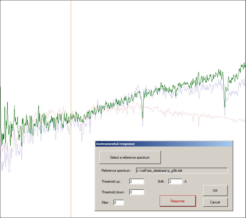

Type G8 has a better fit in blue, but weak signal questioning it, continuum slope and missing H-alpha hole tells at least the main component is not this type:

Note: I was already able to guess as K3III (+/-1) for the 1st noisy attempt of 3 x 10 minute, too. Obviously tried the V variants as well.
