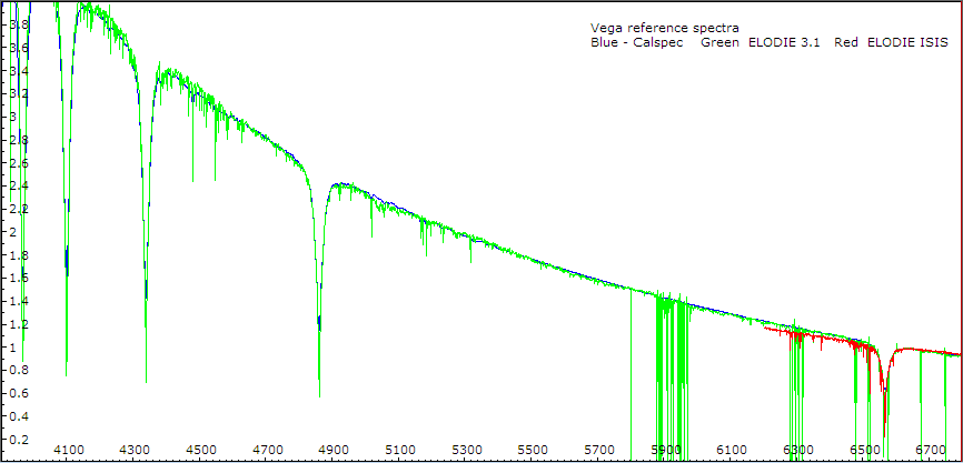

I have a doubt concerning Elodie spectrum of Vega whose profile is enclosed in ISIS database. If I compare it with Calspec spectrum, I can see a large deviation of the continuum slope (I think considering the small interval):
Note it's the same with Pickles A0V. Which one is correct? Is the Elodie Vega profile the same of 3.1 library?
Re: ELODIE 3.1 - 1388 high res flux calibrated reference spe
Hello Paolo,
I agree. There is a problem with the ELODIE spectrum of Vega in ISIS. This is the danger when using spectra directly from the ELODIE archive. If you look in the ELODIE archive,there are several Vega spectra but they do not all look the same! This is the advantage of the ELODIE 3.1 library. There are 3 Vega spectra in the library which are very similar. They also agree well with the CALSPEC spectrum.
(The zero values in the ELODIE 3.1 spectrum are telluric wavelengths)
