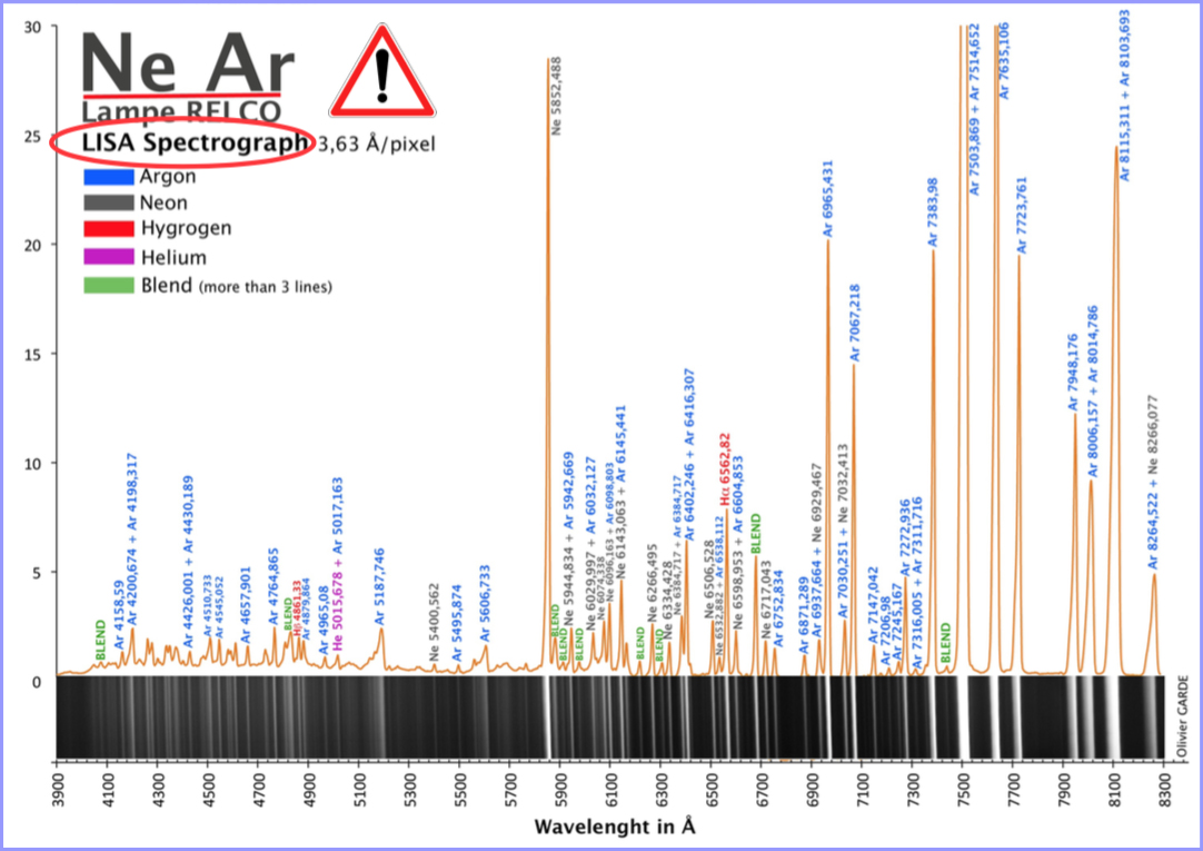

Je cherche à identifier la longueur d'onde des raies de mon système de calibration Alpy...
Existe-t'il un document à ce sujet?
Merci d'avanve..
I'm looking for a document indicating the wavelength of the calibration module of the Alpy..
Thanks for your help

Hi Jean-Paul,
I've found this one, actually for the LISA, quite good for the Aply - much better than the one in the Alpy manual.
The attachment may not be very good quality (I extracted it from one of Olivier's presentations), but hopefully some one will have a higher resolution copy.
Paul

Thanks Paul,
"Relco" was a hint to go further on the net...
up to this atlas of relco lamp emission lines: http://www.ursusmajor.ch/downloads/sque ... es-3.0.pdf
And I found that on stargazerslounge.com
"note that If you use ISIS to calibrate your relco lamp spectrum, just telling it the position of the one bright Ne line at 5852A, it will produce a fully calibrated spectrum of your lamp automatically"
I tried that (just have to change the x scale in gnuplot)
