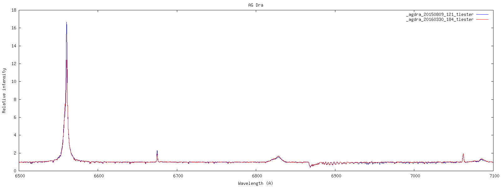

Post by Tim Lester »
Here is my Mar 30th result for AG Dra compared to my last observation of Aug 8 2015
(R = 9000)

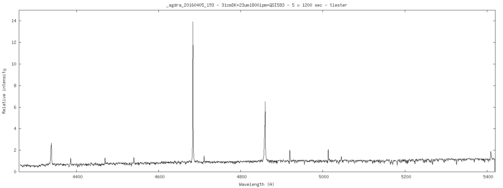

Result for Apr 5th. This time centred on Hbeta at R = 6300
Re: AG Dra
Hi Tim, thanks for sharing. It appears that He II 4686 has changed a lot in the past few days. I noticed it on a low-res spectrum taken yesterday by an italian amateur (Paolo Cazzato) with an Alpy 600. Then I looked here for confirmation, finding your excellent spectrum.
The ionized helium line is a bit narrower than h-beta but the EW seems now greater anyway, contrary to what we were able to observe over the past months (years?).
On the ATel #7582 it talk about a decreasing of the very high ionization conditions when the outburst began. The He II 4686 / h-beta ratio reduced to 0.67 at the end of May (2015).
Can anyone explain the astrophysical meaning of the EW change (if real, I haven't the profile for its calculation)?
Thanks,

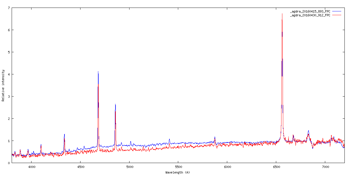

Francisco Campos
Posts: 88
Re: AG Dra
Post by Francisco Campos »
François, excellent your explanations about the outburst of AG Dra. They are a true extra motivation to carry on observing this interesting star.
Here is a comparative of two spectra taken with a difference of two weeks. The last one its a bit noisy... It seems that most emission Balmer lines and the strong He II at 4542 A have faded, together with the continuum. But in the other side H-alpha has increased...
AG Dra .png (10.01 KiB) Viewed 10665 times
Greetings
Fran

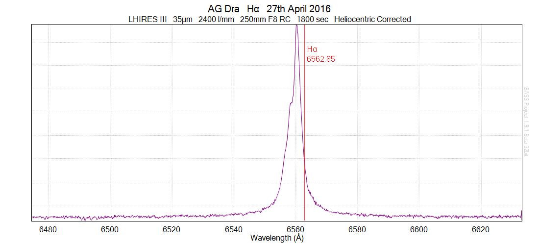

Posts: 458
Re: AG Dra
Here is a spectra, using a 150 ln/mm grating, on AG Draconis on 04May16
This spectra was calibrated and instrument response corrected.
I was wondering why my Balmer H and He lines are slightly "blue-shifted" with respect to the telluric Hg and O2 lines I calibrated against; specifically,
Hg(5460.74A), O2(6860.0A), & O2(7605.0A) lines.
I have a neon calibration image, but when applying it, the H & He's show the same displacement. I was using a 17" scope at F/6.8, with a JTW L-200
spectroscope with an SBIG ST-10xme camera.
Here is another spectra taken 23 April 2016 showing similar "displaced" H & He lines:
This was a mosaic of two spectras taken with a higher resolution 300 ln/mm grating, neon source calibrated.

Re: AG Dra
Post by AndyWilson »
Hi James,
I checked my AG Dra spectrum from 27th April and I also see a fairly sizeable blue shift of over 100km/s after heliocentric correction. I did a bit of investigation and according to SIMBAD the star has a high radial velocity of 147 km/s towards us which would explain the blue shift.
http://simbad.u-strasbg.fr/simbad/sim-i ... =submit+id
AG Dra 27th April
AG Dra 27th April
AG Dra 27th April
Best wishes,
Andy
Posts: 458
Re: AG Dra
To: Andy,
Thanks for the quick response! I install the latest Bass 1.93 and tried velocity correction, but it was only about 4 km/sec and did not
shift the H & He lines appreciably. Thanks for the realty check!
