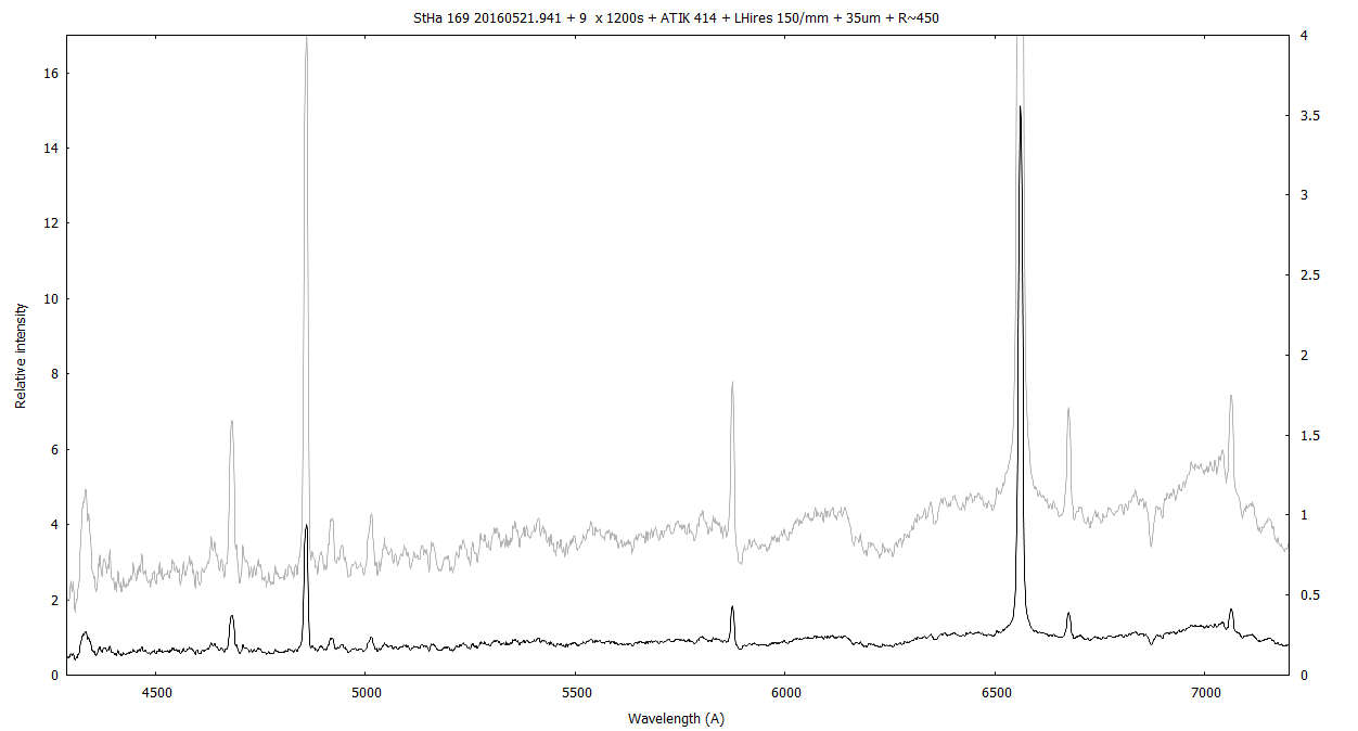

Re: Symbiotic StHa 169 in outburst
Had this star a sleeper project for the 2nd half of the night:
Had some veils meanwhile, basically slept it over.
Comparing to David Boyd's data from 05.14, doing gauss filter of 2.5/ISIS showing only a minor drop of Balmer and HeII 4686 as a difference, otherwise everything very similar (note that my LHires gets defocused in H-gamma). Had to use 1 sec exposures, that is my typical limit for slit-based guiding (means a star roughly at 13 mag, +/-0.5).
I can measure an EW ratio of Hb/HeII of 3.5 in ISIS.
Posts: 1565
Excellent results, Peter and David, on that faint target
