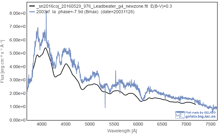

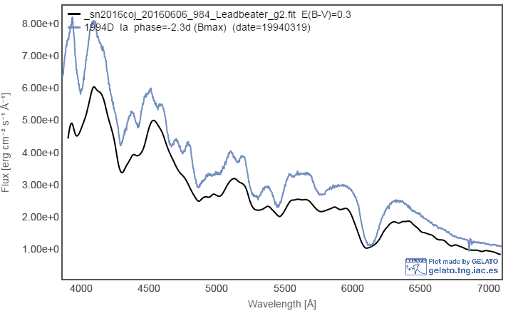

Re: SN2016COj
Hello Etienne,
A nice result!
Here are my two spectra taken 20160529 and 20160606 (black), compared with the best fit spectra from the GELATO supernova identifcation program (blue)
https://gelato.tng.iac.es/
The resolution is lower than yours at R~150 as my modified ALPY is designed mainly for much fainter supernovae.
To measure the velocity of the ejected material in 1a supernovae, I think the usual method is to measure the wavelength of the 6360A Si II absorption line minimum. After correcting for the redshift of the galaxy (z=0.0045) I get a velocity of ~15500km/s for the first spectrum, slowing to ~14000km/s for the second spectrum 8 days later.

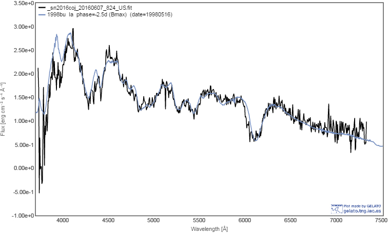

Salut, moi aussi je l'ai observé le 06/07/2016 cette supernova avec un ciel légèrement voilé.
Selon mon profil Gelato il classé, avec 100% de certitude, la supernova de type Ia.
Placez une comparaison entre mon profil et celui de SN1998bu trouve de Gelato.
Salutations Umberto
