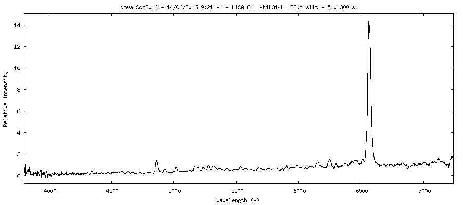

Terry Bohlsen
Posts: 191
Re: Nova Scorpii 2016
Post by Terry Bohlsen »
Here is my spectrum from 2 nights ago.
It isn't the brightest object at mag V=12.39
Terry Bohlsen

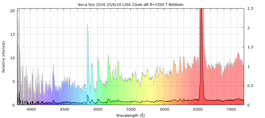

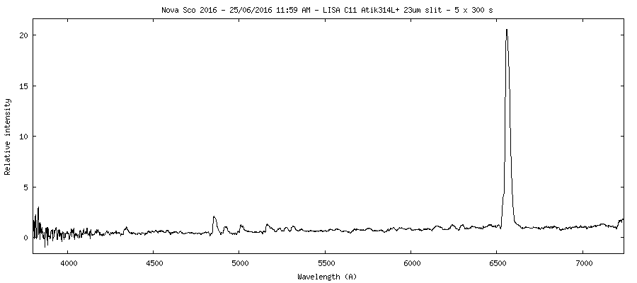

Terry Bohlsen
Posts: 191
Follow up spectrum from last night. We've had lots of cloudy nights so imaging has been limited. It was -3deg C last night when I took this. Brrrrrrr
Ha has increased n strength with a stronger P Cyg profile.
Terry Bohlsen
Armidale NSW
Australia
Posts: 1568
New page in ARAS Database for Nova Sco 2016, with Terry's spectra
http://www.astrosurf.com/aras/Aras_Data ... co2016.htm
