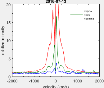

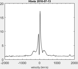

I observe yesterday this target. Full profile:
Heliocentric radial velocity of h-alpha line:

Nice, Paolo !

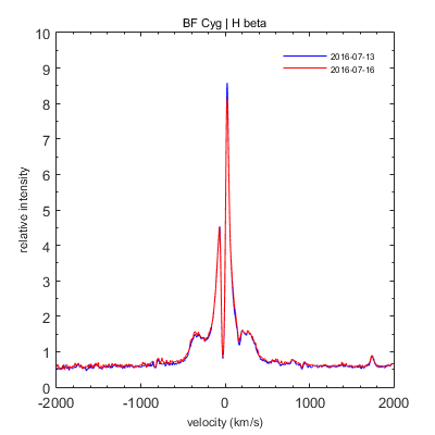

The satellite bumps are clearly seen at R = 5000

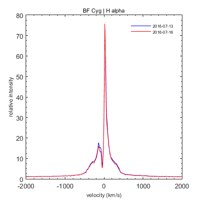

Here's a comparison (13 and 16th of July) Observation scheduled tonight
A high cadency coverage should be great
PS : 31°C in Normandy at Midnight ... CCD Cooler at 0°C

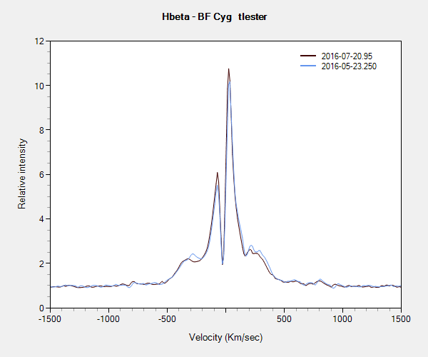

My latest spectra for July 20th at Hbeta (R = 6400) compared to my last result on May 23rd

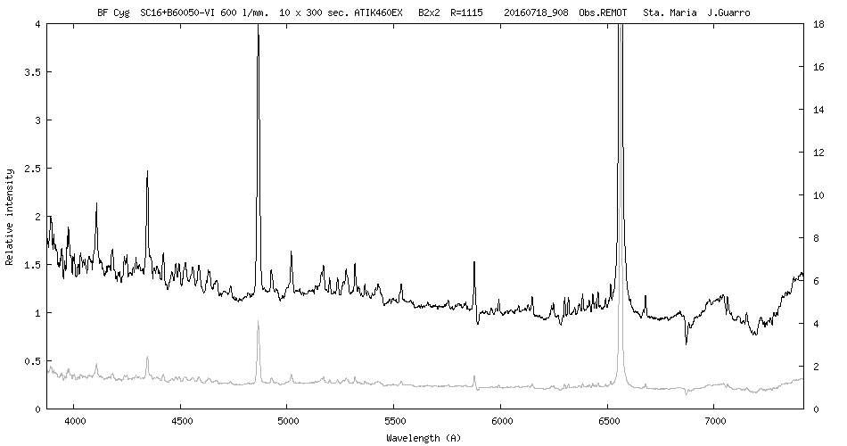

Hi :
Vission of BF Cyg in low resolution.
Regards, Joan.
Regards, Joan.

Nice resolution, Joan !
Tim : very interesting. The outflows appears before June.

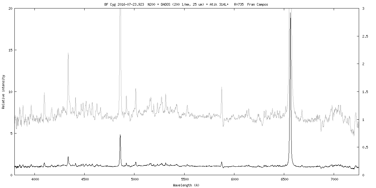

Francisco Campos
- Posts: 88
Re: BF Cygni : strong jets
Excel·lent resultat, Joan,
Here is my contribution from last night. Not as good as Joan's one, but I am happy with the result.
Greetings
Fran
Greetings
Fran

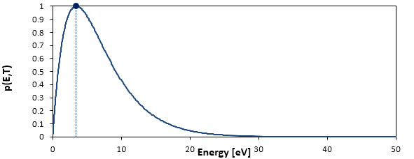

Here's the maxwellian distribution of energy for a temperture of, say, 40 000 K
according to the energy in eV
There's only a few photons emitted by the pseudophotosphere above 24.6 eV : He remains neutral, so no emission lines of He I (or very faint)

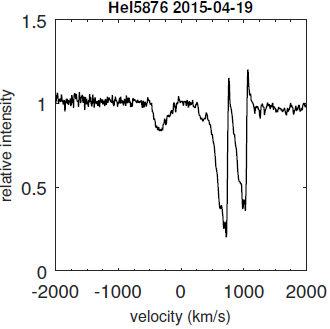

He I appears essentially in absorption, probing the strong (stratified) wind from the hot star (about 450 km/s)
