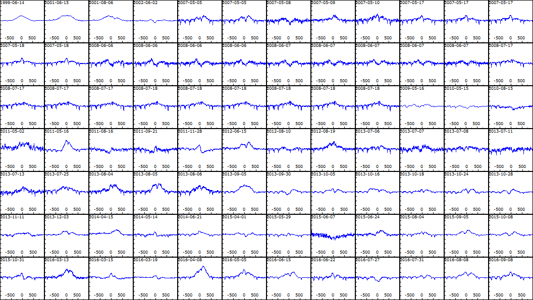

Yes cx dra is a star which has a profile which evolves quite often. In fact it is a Binary star B3+F5III
Here is the summary view for all the BeSS spectra - evolutions from day to day can be observed. Would worth a look at litterature.
V.-
