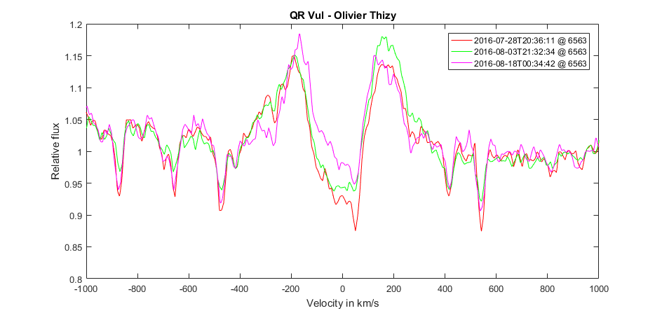

Post by Olivier Thizy »
I have been working on a tool (ie: function) in MatLab to display spectral profile from FITS file we use to work with in astronomical spectroscopical community (ie: BeSS file format).
This is highly preliminary but just to start discussion around this subject, I publish here my initial code. Again, this is Work In Progress but maybe it can help you.
Just copy/paste this code into "otz_plot.m" file within matlab working directory.
Then go in matlab to a directory with at least one FITS file profile and type in the console for exemple:
otz_plot -h : for help
otz_plot 'filename.fits' : display your spectrum
otz_plot 'all' : display all FITS file spectra in your directory (could be messy if lot of them!)
otz_plot 'Ha' 'filename.fits' : to display Halpha from your spectrum (you can use 'Hb', 'Hg', 'D' for doublet, 'Ha+He' for both Halpha & HeI line...
otz_plot 6502 6603 0 4 'filename.fits' : here you specify the wavelength & Intensity limits
otz_plot 'filename.fits' -w 'Ha' : display in radial velocities Halpha
otz_plot 'filename.fits' -w 'Ha' -w 'Hb' -w 'Hg' : display in radial velocities Halpha, Hbeta & Hgamma
This is really WIP but do not hesitate to post here if you have comments or would like to see improvements in this code...

here is v1.1 of the script with legend added:
Without -c option, the script is using standard colors for spectra in that order: b=blue, r=red, g=green, m=lagenta, y=yellow, c=cyan, k=black
You can specify colors with -c 'rgb' for exemple and graphs will be red, then green then blue and cycling...
I also added legends with DATE-OBS and central wavelength for plot in radial velocities.
Here is an exemple of three spectra of QR Vul I took recently, plotted in one line using command:
otz_plot 'Ha' 0.8 1.2 'all' -w
QR Vul
QR Vul

>otz_plot 6500 6600 0 5 'filename.fits'
(here 0 5 are the Y-axis limits for the graphs)
>otz_plot Ha 'filename.fits'
(some codes can be used to quickly select the line to display; 'otz_plot -l' to list the line codes)
>otz_plot 'filename.fits' -w Ha -w Hb -w Hg
(the same line codes can be used for velocity plots)
-w (wavelength) options are the same as the line codes given by 'otz_plot -l'
----- Options for line color(s) & style(s) -----
>otz_plot 6500 6600 0 5 'all' -c bgr
-c (color) options: b=blue, r=red, g=green, m=lagenta, y=yellow, c=cyan, k=black
>otz_plot 6500 6600 0 5 'all' -d sp
-d (line style) options: s=solid, d=dash, p=dotted, m=dash-dot
----- Options for legend(s) -----
>otz_plot 'filename.fits' -l X
-l (legend): you can specify what data you want to display in legend for each graph
'legend' are codes also used for the -t (title) option; they are:
X or x means no legend
D: date in DD-MMM-YYYY HH:MM:SS
e: exposure in sec)
i: instrument
h: heliocentric JD -2400000
j: julian date -2400000
J: full julian date + 3 digits
l: location site code
L: full location name
n: filename
o: Observer code; O: Observer full name
r: resolution power of the instrument
t: target name (standard)
T: object name from FITS file
w: wavelength, no digit (when option -w is used)
Exemple: '-l Do' to display both date & observer code in legend
(by default legend option is 'Dwo': Date - wavelength - observer code
----- Options for main title -----
>otz_plot 'filename.fits' -t o
-t (title): you can specify what data you want to display as title
X or x means no legend; 'title' is similar to -l (legend) options
(by default title option is 'tDeLiO': target / Date / exposure time / full location / instrument / full observer name
----- Options scaling Y-axis & X-axis -----
otz_plot -500 600 0 10 all -s 6540 6542 -w Ha
-s: rescale to 1 beteen 6540A & 6542A
>otz_plot 'filename.fits' -x -18.3 -f 'filename2.fits' -x 23
-x RV: use the object RV if known (see rfitsinfo.m / use CDS to get RV)
-x H: heliocentric correction (minor bug in calculation)
-x RVH: object RV *and* heliocentric correction
-x nA: apply a shift of 'n' Angstroems
-x v: apply a shift of 'v' in km/s
otz_plot -500 600 0 10 all -t object -y -0.01 -w Ha
-y i|t|p scale (epoch period) with options:
-y i scale / intensity plot; scale = intensity shift between each graph (ex: 0.5)
-y t scale / time plot; scale = days to intensity scaling factor (0.01 for exemple; 100days = 1 in intensity)
-y p scale epoch period / phase plot; phase to intensity scaling factor, epoch in Heliocentric Julian Day, period in days
(for ex VV Cep: -y p 100 2438481 7430) [=Emin / Wright, R.A.S.C. Jour., Vol 71, 1977]
(note that -y option is usually used in conjunction with -s option to ensure proper intensity scale)
otz_plot Ha all -t object -s 6540 6542 -y 0.5 -w Ha
-y: if positive, shifts all spectra by 0.5 Intensity
I hope you'll enjoy it !
