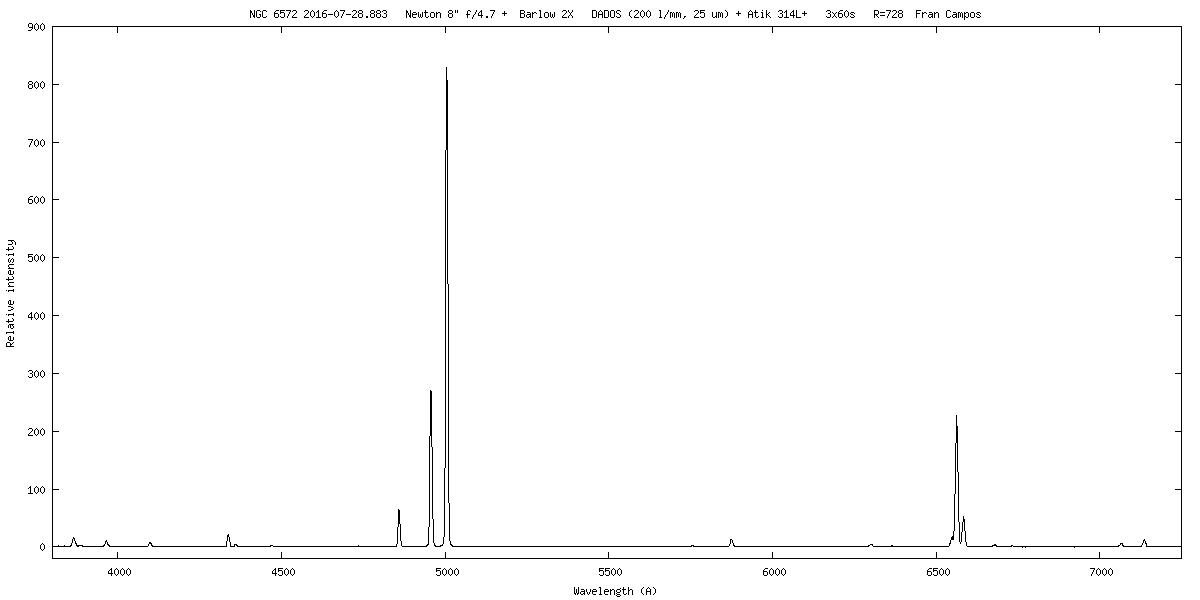

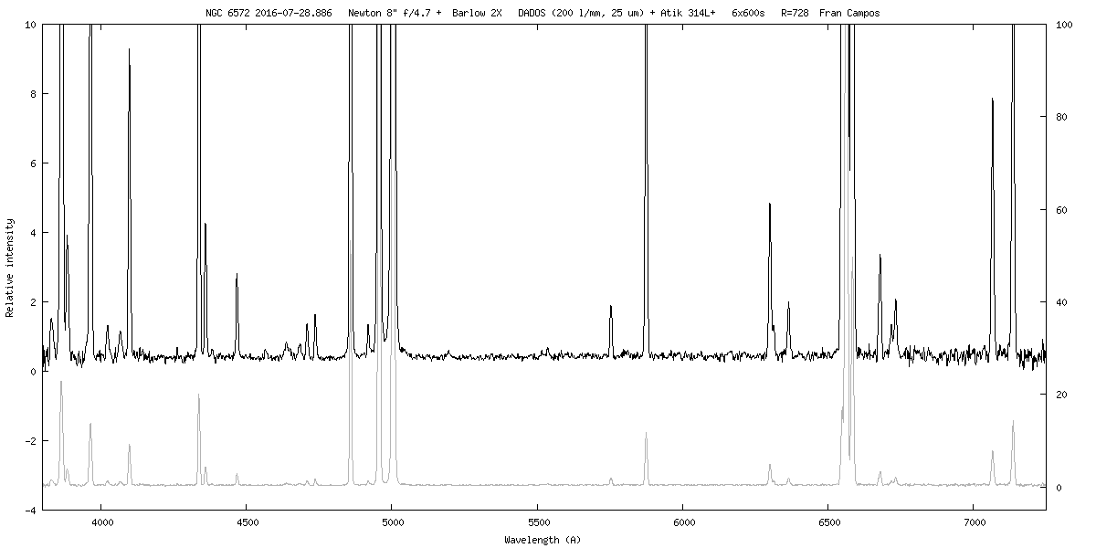

voici des spectres de deux nébuleuses planétaires assez brillantes, spécialement NGC 6572 où j'ai saturé les raies les plus intenses pour faire visibles de nombreuses raies plus faibles comme les de l'[Ar IV] à 4700 A.
_ngc6572_20160728_883 60s.png (6.1 KiB) Viewed 3811 times
_ngc6572_20160728_886 600s.png (11.6 KiB) Viewed 3811 times

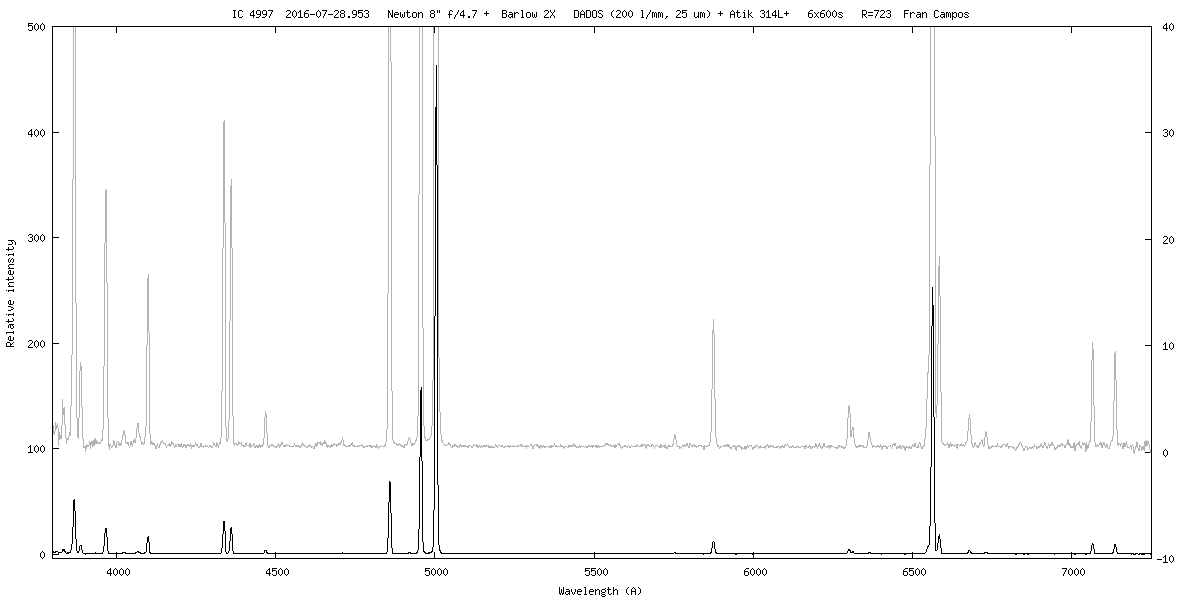

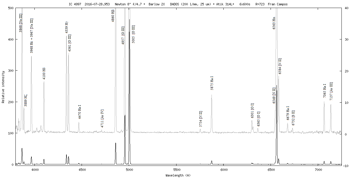

Meanwhile, I have identified almost all the lines of the spectrum of IC 4997, although there are two lines at 4000-4100 A that I failed to identify. Also I see some errors in the position of some bands: for example, the [O III] bands have an error of 2 A. Maybe a calibration error? I have utilised 10 lines of calibration (RELCO lamp). :?:
_ic4997_20160728_953 spec.png (26.74 KiB) Viewed 3762 times
