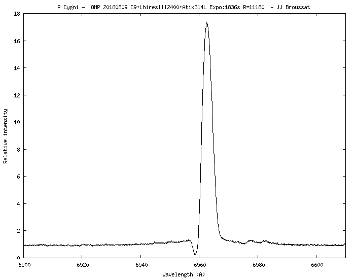

voici un spectre de P Cygni pris le 9 août 2016 à l'OHP
setup: C9 + Lhires3 2400 + atik 314L
R= 11180
etoile de réf: hd192640
Cordialement
Jean-Jacques

- Posts: 461
Re: OHP 2016 - P Cygni
Jean-Jacques,
I am interested in your spectrum for our intrinsic flux monitoring.
Would you be willing, to send me this ?
Ernst
Ernst
- Posts: 370
Ernst,
Jean-Jacques spectrum is available on ARAS database:
http://www.astrosurf.com/aras/Aras_Data ... V/PCyg.htm
Observer code is JJB

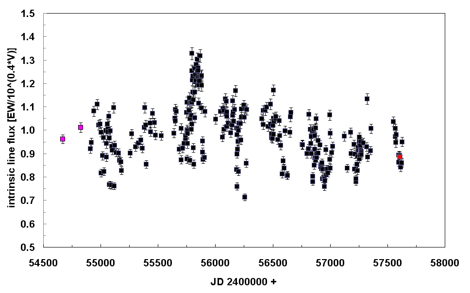

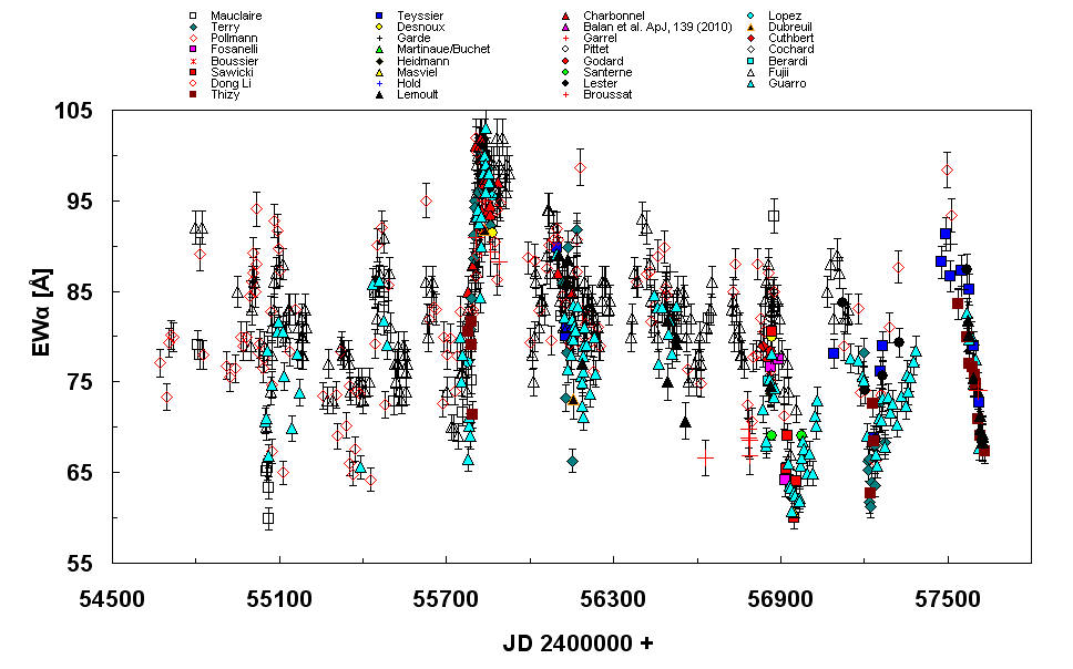

- Posts: 461
Jean-Jacques,
here comes the EW and intrinsic flux evaluation of your spectrum.
As you can see, everyting fits very well!! Ernst
