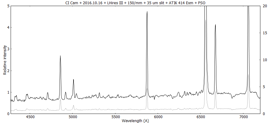

Hi François, thanks for the alert. For me an unusual profile. It seems that all emission lines are double-peaked (at first I thought they were broadened). With an higher resolving power you should see better.
Just finished a session with Lhires III and 1200 l/mm grating. About 20000 ADU counts for the h-alpha with 960s exp (C9.25, SXVR-H694):

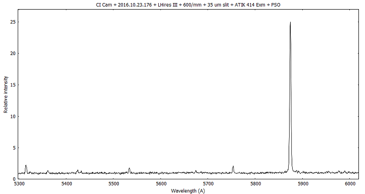

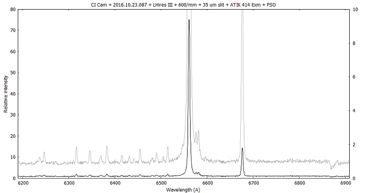

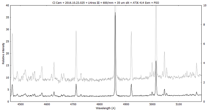

Last night's result, this time with the 600/mm grating (300/1200 Newton + LHires):
(6 x 10 minute, mostly clear sky, R~1800)
(3 x 10 minute, with cloud interrupts, R~2500)
(1 x 10 minute, clouds fully closed then, R~2000)
Although SNR is not the best for this last one, EWs look still usable.
If my understanding from alert notice is right, the mentioned [NII] 5755 should be the tiny peak left to the big He I 5876.
Line identifications would be appreciated.
