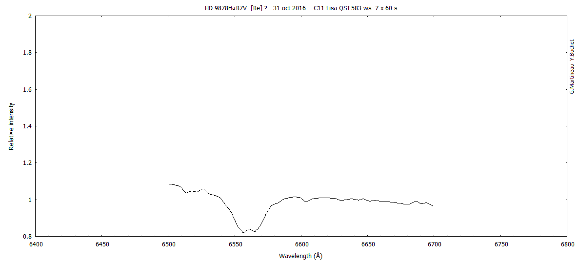

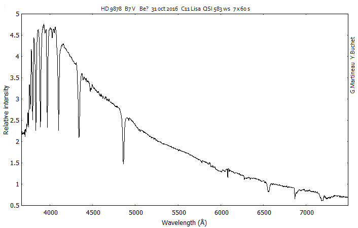

Bonjour à tous,.
Ci-joint le profil de l’étoile HD 9878 dans Cassiopée, lequel présente une très faible émission au creux de la raie H alpha.
Ses caractéristiques sont: m= 6.7; sp=B7 V; B-V=0.016; H-K= 0.032;
Cette étoile aurait besoin d’une confirmation extérieure en haute résolution (critères 3 et 4 d’Andrew Smith) pour se présenter au statut de candidate Be ou de Be déclassée.
Merci à l’avance.
Cordialement
Attached the profile of the star HD 9878 in Cassiopee which presents a very weak emission in the hollow of the line H alpha. Its caracteristics are: m= 6.7; sp= B7 V; B-V=0.016; H-K=0.032.
This star would need an outside confirmation in high resolution (criteria 3 and 4 of Andrew Smith) to appear at candidate’s status Be, or of relegated Be.
Thanks to the advance.
Cordially.

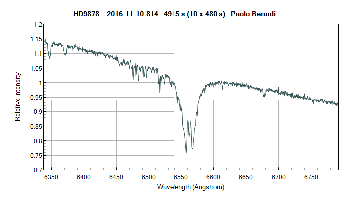

Gerard, Yolande, very interesting finding! Not easy with a low resolution profile.
I just observe it (was cloudy before) with Lhires III 1200 (R~6000) and confirm an emission double peaked component.

I think we should send our data to Thierry Lemoult for adding to the possible-Be database (it seems to me that HD9878 is not included) and continuing to monitor the star for any changes.
