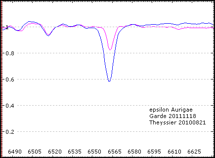

Re: eps Aur au LISA
Hi Olivier,
Here as a comparison of H alpha in your spectrum with one taken by Francois Teyssier at mid eclipse using a LHIRES III 150l/mm. The additional absorption from the eclipsing disc is very clear even in low resolution spectra.
- low resolution spectra of eps Aur H alpha at middle and end of eclipse
- epsaur20100821_20111118.png (6.75 KiB) Viewed 26773 times
