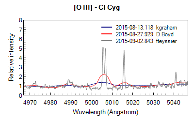

Here's a comparison of [OIII] 5007 range for symbiotic CI Cygni at R = 600 (Alpy) and R = 1000 (Lisa)
The grey spectrum obtained at R = 11000 gives the "real" profiles
This region is interesting because of three main lines [OIII] 5007, He I 5016 and Fe II 5018 (He I and Fe II according to the orbital phase)
The two lines OIII and Fe II are obvious and well separated with Lisa, not with Alpy.
Even when the lines are stronger, the intensity of the two lines can be measured for Lisa with a gaussian adjustment. This is not possible with Alpy.
This point is important because it allows the measure of electronic temperature with the spectrum obtained by Lisa
Other lines for a diagnostic :
H gamma and [OIII] 4363,
or in NP : [SII] 6716 6731 (electronic density), well resolved with Lisa
I recommend Lisa
