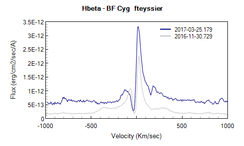

H beta evolution
bfcyg_ 20170325_179_fteyssier.png (15.31 KiB) Viewed 3969 times
with already changes in the profile of H beta absortions since the published spectrum
BF Cygni still rises
Fe II (42) multiplet with the P Cygni profiles

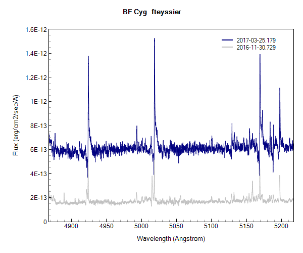

bfcyg_ 20170325_179_fteyssier_FeII.png (40.97 KiB) Viewed 3966 times
Of course, more spectra are welcome
The spectrum is evolving quickly
