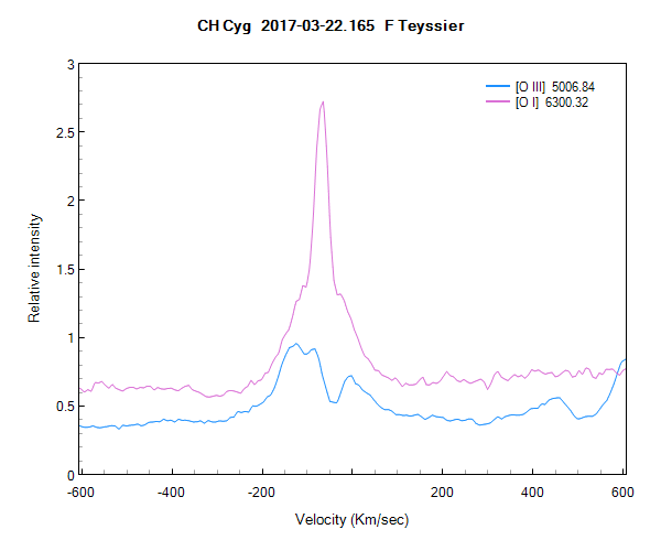

I just see that the important value 'Integrated flux' is missing in the stats report.
Another suggestion: adding a 'Normalize to active series' in the 'Velocity plot' when comparing lines in the same spectrum
chcyg_ 20170322_165_fteyssier.png (18.37 KiB) Viewed 3342 times
Thanks again,
Tim Lester

Thanks for finding that François. I'll add the integrated flux to the list.
Regarding the multi region velocity plot. If I understand correctly you are wanting to bring the continuum into alignment for the different spectral regions.
Currently this can be done by using the "normalize continuum" function on the main plot. The multi region plot will change accordingly.
As it stands this normalization is a one way process - you cant go back. I plan on changing this so that a new normalized series is generated instead (and labeled accordingly).
This way you can go back to the original at any time.
