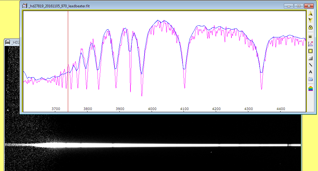

Here is an example of one of my reference stars. The noise in the flat corrected image in the blue end looks bad but the resulting response corrected spectrum is fine. (blue is the measured spectrum, pink is the actual spectrum from the MILES library)
- violet_region_measured_v_library.png (127.61 KiB) Viewed 8386 times

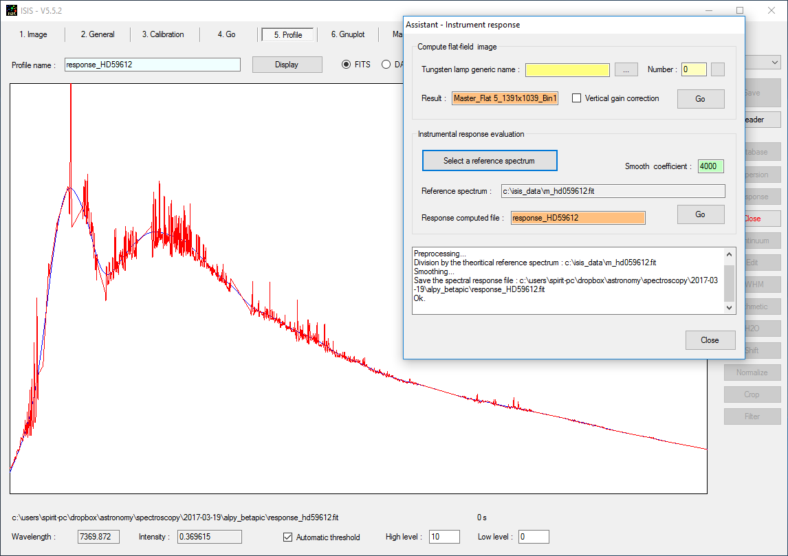

Another clue is the strange of "malformed" response profile I get when I run the Response Assistant; see:
[NOTE: I used only 7 flats on this response, but the number of flats and/or the smooth coefficient does not alter the scaling problem or "smooth regions"]

I've sometimes found it necessary to increase the smoothing coefficient to bizarrely large values for Alpy spectra (see screen shot). Also, it's possible to compare the results of using different coefficients to the standard by disabling the deletion of intermediate files (found on the settings tab). The compare file is called @@.fit.
Paul
Re: response assistant.
Paul

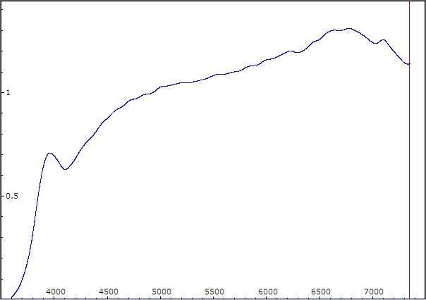

Re: Isis processing issues
Hi James,
I'm not sure what is going wrong in this case. With those masters it should have been possible to get a good response way below 3900. Here for example is my response calculated using the MILES reference star from my previous post.
- _hd27819_20161105_970_response.png (3.84 KiB) Viewed 8335 times

Thanks for the screen prints.....in my case...using huge Smooth coefficients makes the response curve look better.
To: Robin,
All my response curves look like Paul's or worse; mostly way worse. Seems all my respose curves turn-out like straight vertical lines unless I crop. If I crop too much into the UV (say shortward of 3800A) the curves stay vertical lines! More recently I've gotten a response curves that causes the reference A-star spectrum to be perfectly shaped to the Miles, but it ends up either above or below the reference star's process spectrum; see this example of a A3V star SAO84281, next to R & T CrB:
I have never yet, after processing 12-15 response curves, got one that looks like Your's of Christian's. This is despite the fact I've increased the exposure of both reference A star and flat; almost hitting 60K adu in medium stretch as seen in Maxim DL's stretch window. Isis is very powerful, but very hard to get results you Pros have gotten without doing the processing for each pair (reference star/object) about 10X on each of the steps that Christian summerized in his wonderful, but brief tutorial.
I guess I'll have to put a couple of hundred more hours to replicate the results you typically see in ARAS forum. I wont even attempt high resolution until I can do the LISA spectra reductions! The IR kit will sit in its box until deep in the Summertime until I can overcome these software difficulties!
To: Robin,
