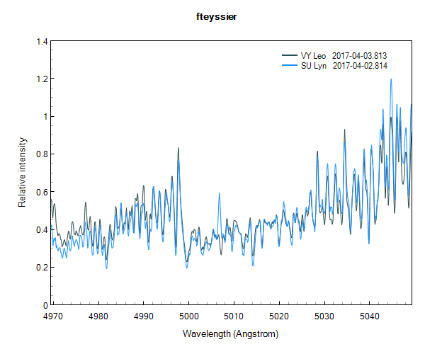

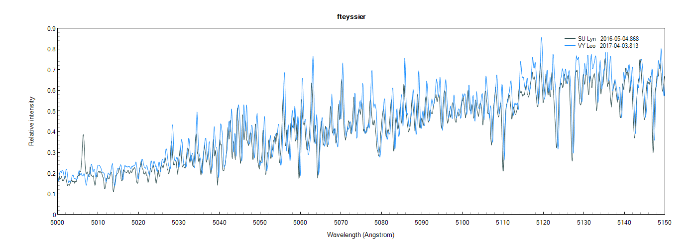

I work on a crop of the spectrum [5000..5151]
Here's teh comparisation of the two spectra, showing the radial vélocity of SU Lyn
Computation with ISIS Radial velocity gives a vlaue of -18.0 km/s for 02-04-2017. I estimate the error at ~ 1 km/s
More data will produce the radial velocity of the system and the orbital varaition of the red giant.

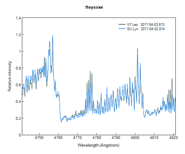

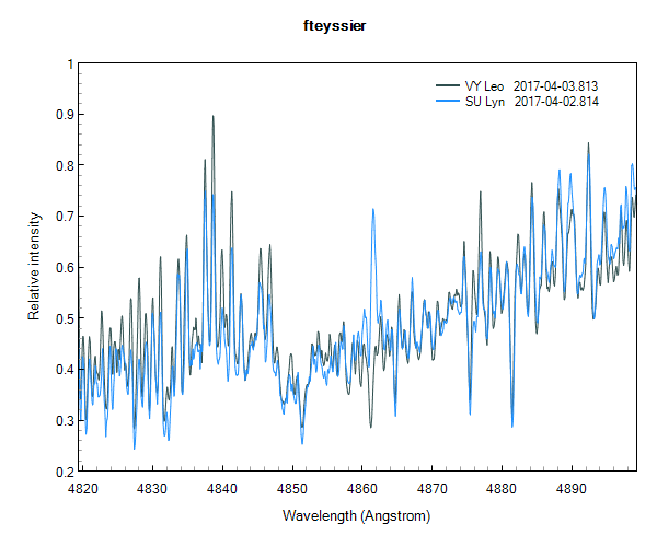

Then, I shift the spectrum of SU Lyn of +18 km/s
This give access to the (currently) very faint emission lines
H beta
sulyn_ 20170402_814_hb.png (65.55 KiB) Viewed 5373 times
[OIII]
sulyn_ 20170402_814_oiii.png (52.37 KiB) Viewed 5373 times

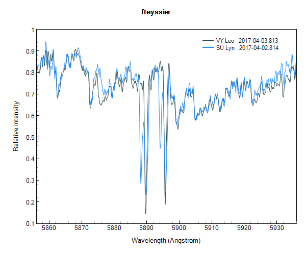

Then, we can get the real value of the intensities of the lines after substraction of the psesudo continuum of VY Leo from the spectrum of SU Lyn
Na I D range, with interstellar absorptions of D1 D2 and the absorptions of the symbiotic nebula
sulyn_ 20170402_814_NaID.png (44.21 KiB) Viewed 5373 times
Matche well:
sulyn_ 20170402_814_4800.png (51.77 KiB) Viewed 5373 times
