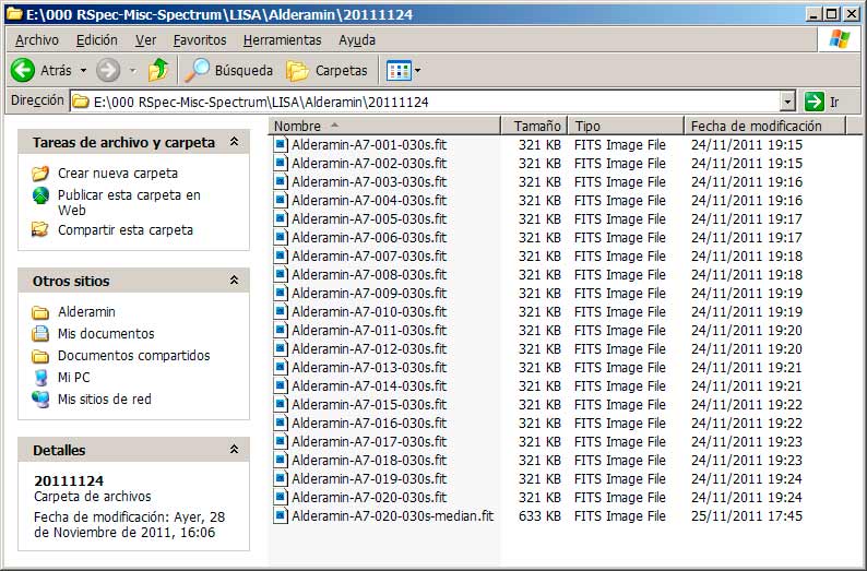

Yesterday I took a look at the "Quicklook" and honestly have to say that the first hurdle is the way of opening the files one wants to process. Just the fact that I am not able to search in my disk using the a little window (like Visual Spec offers) for opening the files made me loose the interest in continuing to use ISIS.
Another point is if I want to process several files the expected numbering system by ISIS is not acceptable for me. It would be by far better to be able to choose several files like it is possible in Windows.
I make all my imaging of spectra in MaxImDL and the file numbering system is different. The file number is not at the exact end of the file name before the dot. The sequential number of my images is before the time which is automatically added by MaxImDL.
Look at the attached image
I thought I just let you know my problems with startting up in ISIS.
Thank you for reading and listening to a beginner who would like to use ISIS.

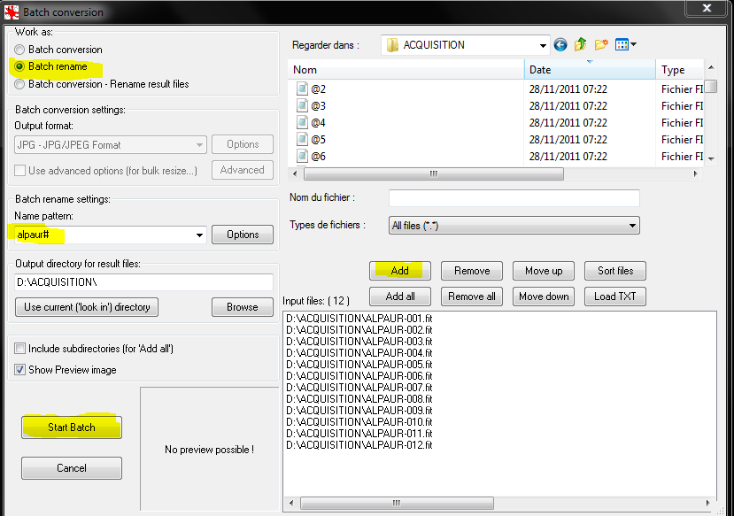

Hi Rainer,
About the MaximDL name format I use the following method :
Batch rename in Infranview
IfranView is a free software : http://www.irfanview.com/
In the File Menu, you choose "Batch conversion/rename"
You get the following window :
Choose Batch Rename option
Add the files to rename
Name pattern : enter the name of the outfile followed by #
The "Start Batch"
Very esay and quickly.
Best regards
The "Start Batch"
Best regards
