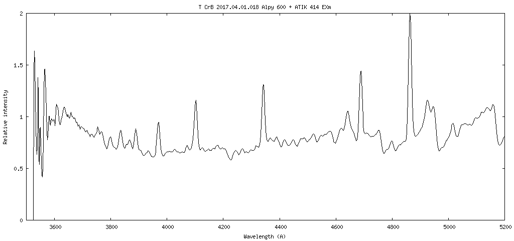

Let me show a few interesting results:
In the above case, there's a sudden cut at Balmer end. It's not because the object was low (23 degree in my case), that drop is visible on the spectrum end itself visually! (I can see people cutting it here, I'd suggest not to do so even when noisy.)
I would also introduce the practice to send in some noise in the end till meaningful, even if speculative... it's needed at least for SNR estimate, and the definite end is hard to specify. Here in this case, for U band evaluation this hard cut at Balmer end should be something important...

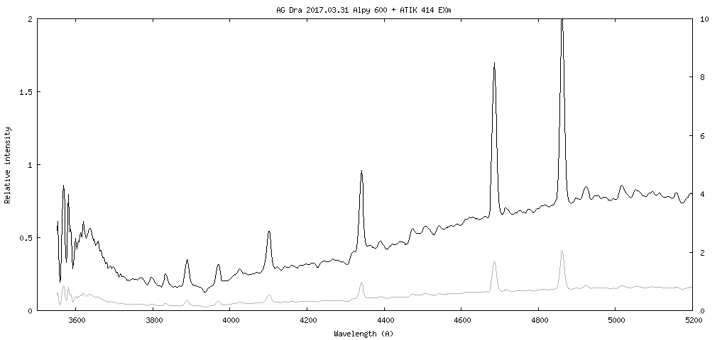

AG Dra is something reproducing here to me, now showing a bit more (including noise as a watermark):

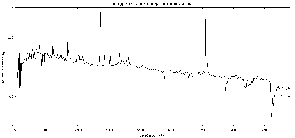

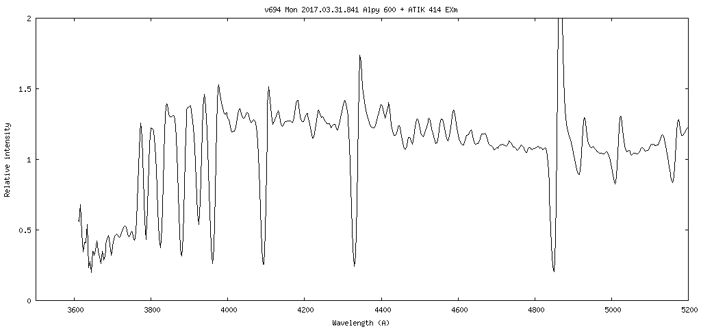

For fullness, a few main targets:
BF Cyg got quite bluish, and using Vega (+ ref star: 1 Sge) did make the continuum much more straight till blue end:
However, below 3650A I'm also uncertain, due to high gradients arise on the IR curve.
