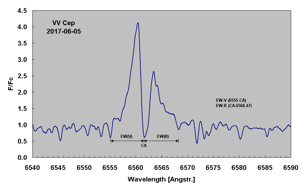

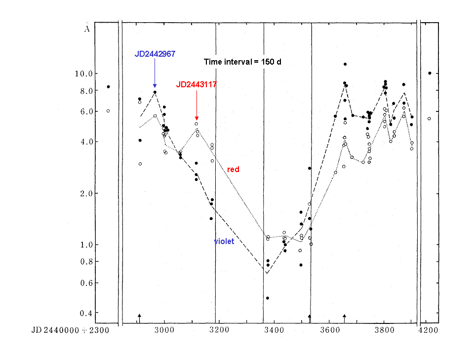

At the beginning of the eclipse, we could observe, the different beginning of the decrease of the intensity of the Halpha emission components V and R. Based on radial velocity measurements of the central absorption core of Halpha, one could calculate the effective radius of the accretion disk of the B companion.
The enclosed Fig. decribes the equivalent widths of the violet (filled circles) and red (opne circles) component of the Halpha emission as function of the Julian Date.
This had been done in the past by Möllenhoff & Schaifers 1978 & 1981, A&A 64, 253-258 and A&A 94, 333-337, and by Kawabata et al. 1981, Publ. Astron. Soc. Japan, 33, 177-188.

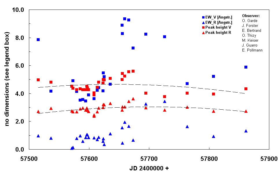

enclosed you can see a plot of the time behavior of the Halpha peak height & equivalent width of the V and R component (from spectra of different observers) in order to get a first impression of the baseline of these emission components out of eclipse. The last measurement in that plot is from April 18th (J. Guarro).
At least the peak heights of both components seems to provide a good chance to determine the exact beginning of the eclipse. The dispersion of the measurements comes from the "natural" activities of mass transfer from the M2 super giant into the B star disk (EW & V/R variability).

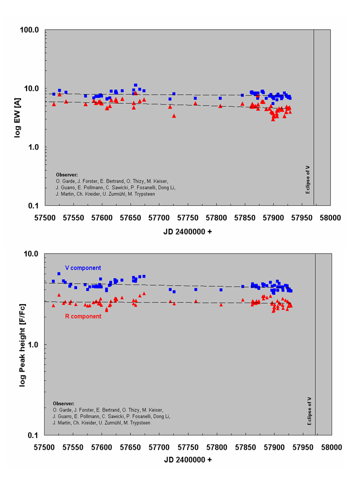

Jack Martin sent me a lot of spectra which did fill some gaps of the year 2015 and 2016 (see the attached monitoring). As we can see, the variability of the peak height of the V component becomes more and more smaller the more the moment of the eclipse is approaching.
I think that in the current phase (shortly before the eclipse and in the line of sight) the large and expanded Halpha emission-forming area (where the scattering will be produced) more and more is diving into the semi-transparent atmosphere of the M supergiant, and therefore the divergence of the peak height variability becomes smaller and smaller.
The divergence should become almost zero (ideal) and the peak height should remain stable, if the moment of the eclipse is reached.

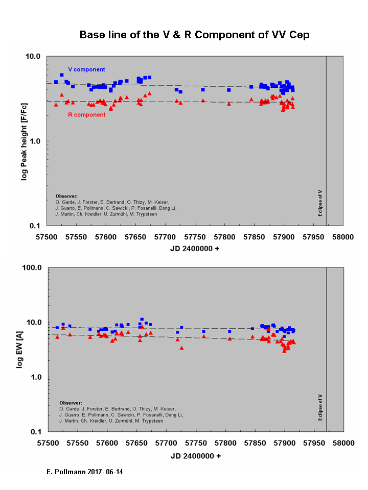

against the background of the VV Cep eclipse, starting on 4 August 2017, an observation campaign during the next OHP meeting would be very helpful. As much spectra as possible during that meeting would contribute to determine the beginning of the eclipse as precisely as possible.
The attached monitoring shows our current effort, to determine the baseline (peak height and EW) of the V and R component before the eclipse (Fig. above)
After a review of the EW evaluation of the used spectra of the different observers with a more precise normalized continuum and a precise wavelength section of both components, this parameter is now useable (Fig. bottom).
Comments are welcome!

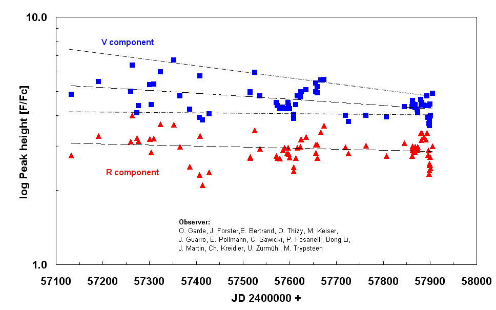

a revision of the analysis of the previous campaign spectra has now led to the use of the equivalent width (EW) of the red and blue components for the determination of the baseline (see attached Fig.)
In view of the immediate imminent eclipse, a well-defined base line now appears for both, the peak height and the EW. At the upcoming OHP spectroscopy session in the last week of July, we will try to improve the quality of the baselines by further observations.
