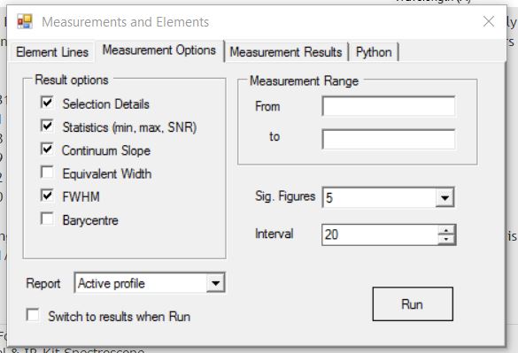

You can use the "Measurement options" in BASS project to find the FWHM of one of the neon lines...it also calculates the R value based on that line. This should be used in preference to SimSpec.

Thanks! I'll check that out.
