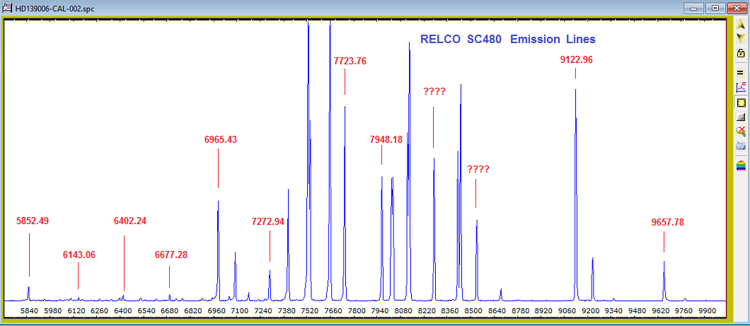

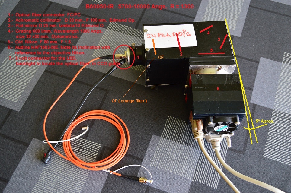

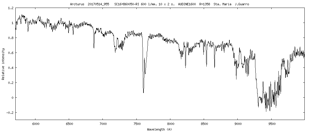

I adapted the infrared spectrograph to Linx's module guide (the Linx is still in the testing).
This is the result with Arcturus. We will see how it can work with stars weakest ....
In favor, you can quickly change spectrograph, just disconnect and connecting the module guide.
In contrast, the respectable AUDINE, do not respond so well as ATIK.
