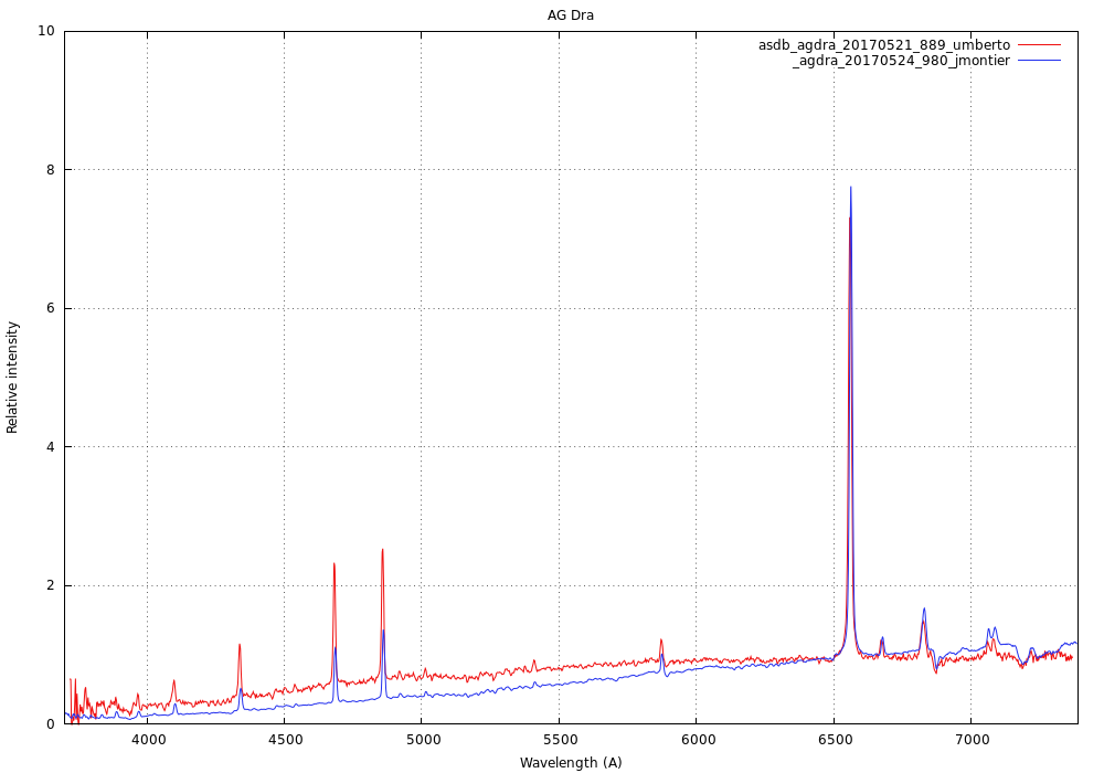

When comparing my spectrum to other spectra (ie Umberto spectrum), i see rather large differences in the blue part continuum.
It is rather surprising as i always use the same harware, software and reference star (HD 145454)
So my instrumental and atmospheric response may be wrong.

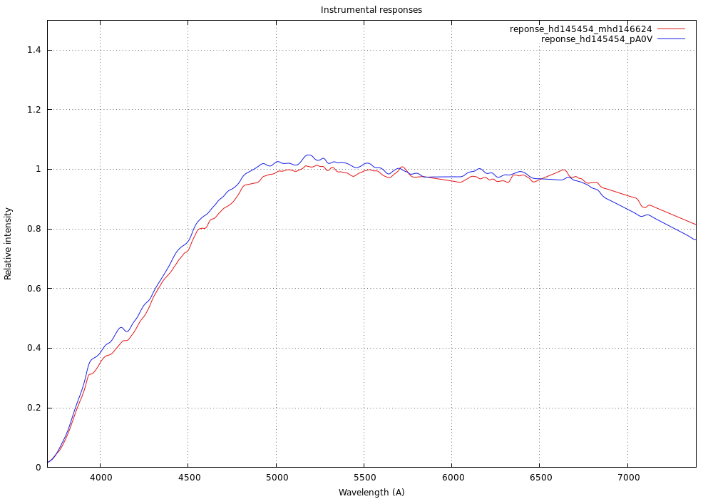

I computed AG Dra with two different database stars (Miles star HD 146624 and Pickles A0V).
Here are the two responses :

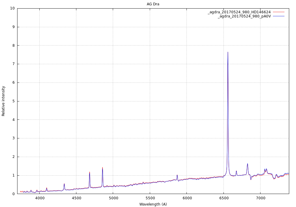

They seem quite similar and the final spectrum :
So do you see what is causing that issue ?

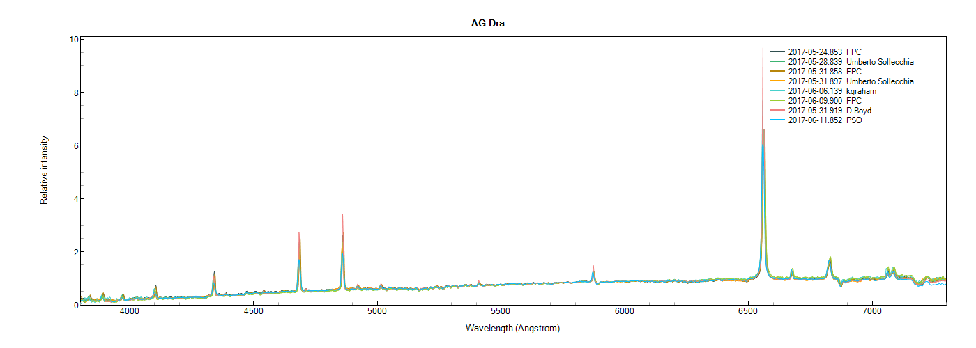

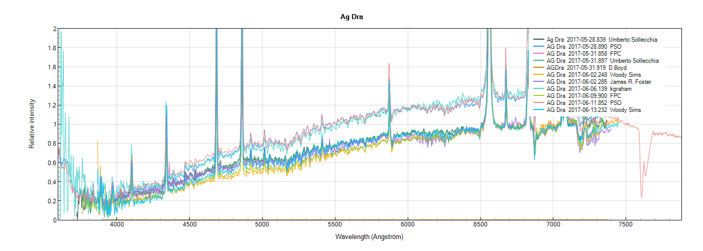

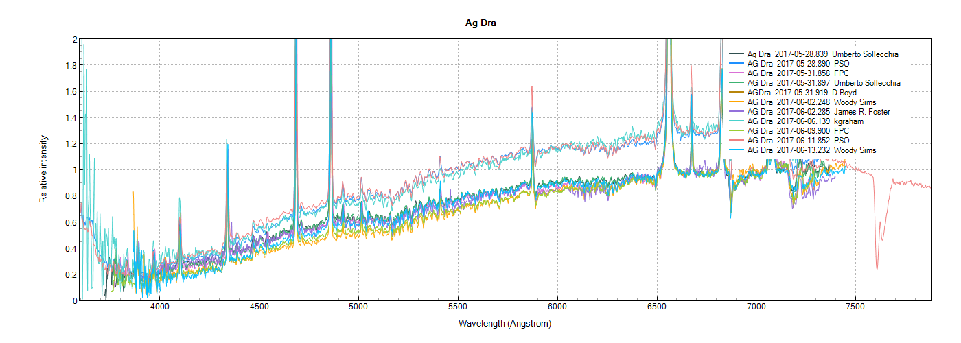

Anyway, to come back on your AG Dra subject, I did a quick survey of the last 11 low resolution inputs on Aras data base. It shows significant variation (object or measurement variation ?). This bring an other question : how to characterize the measurement error (or accuracy level) of the “instrumental response” ? Based on what I see in that example we may have to consider the possibility of a 10% error level in a large frequency band (3800-7200) with low resolution spectrograph.

variation on AG Dra low resolution inputs in Aras data base

The greatest errors are at the blue end below 4000A which is a difficult area to correct for a number of reasons. (Try rescaling all the AG Dra spectra above to 1 at 5500A. This will help show better where the differences are)
The effects of atmospheric extinction, atmospheric dispersion and chromatic aberrations are greatest in this region. (The sensitivity of the spectrograph and output of the flat lamp are also lowest here which can make the noise worse and fitting the response curve more difficult. A large number of flat lamp spectra should be averaged.)

Daniel: AG Dra est en phase calme, on n'attend pas de fortes variations du continuum d'un jour à l'autre
Il est vrai qu'il y a certaines différences dans la base
Mais, dans l'ensemble, c'est correct, voire trés correct !
Le "bon" continuum doit être, à peu près:

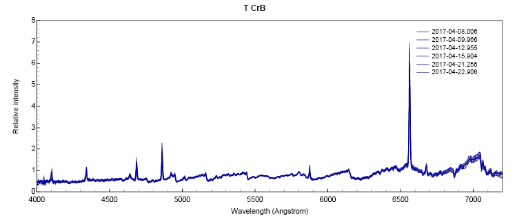

J'avais mis dans la précédente lettre une comparaison des spectres de T CrB obtenus par Fran Campos, Tony Rodda, David Boyd, Woody Sims, Jacques Montier
Verdict : parfait !
