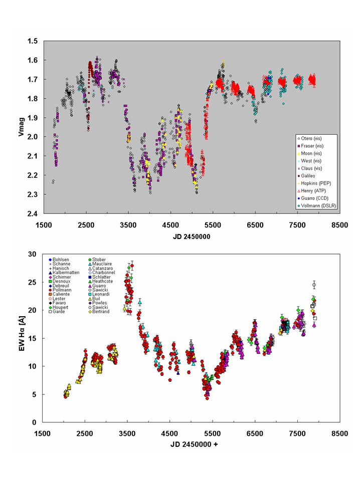

Dear colleagues,
herewith I want to inform of the current state of our del Sco Halpha monitoring. I sent the results to our friend and colleague Anatoly Miroshnichenko. Here his comment:
Dear Ernst,
thank you for the plot. It is good to see that the system is still in its high state. As the secondary companion is still far away from the primary, no big changes are expected due to tidal effects. The primary seems to keep mass loss rate stable.
Thanks to all for their spectra !!
EW versus Vmag.png (169.32 KiB) Viewed 5489 times

I have the context of Vmag to Halpha EW explained something more in detail. See:
http://astrospectroscopy.de/media/files ... k-_II_.pdf

The explanation has been updated:
