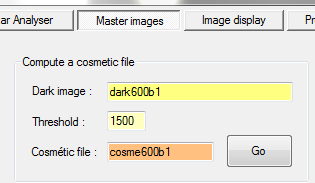

In ISIS, you must first create a file in the "Master Images" tab and then refer to the file name given in the "General" tab :
Best regards
