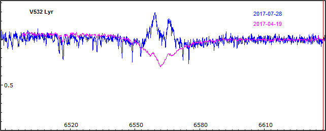

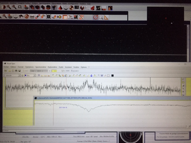

Real time detection of V532 Lyr on the OHP field - spectral type B4Ve - on the 28th of July
And after processing

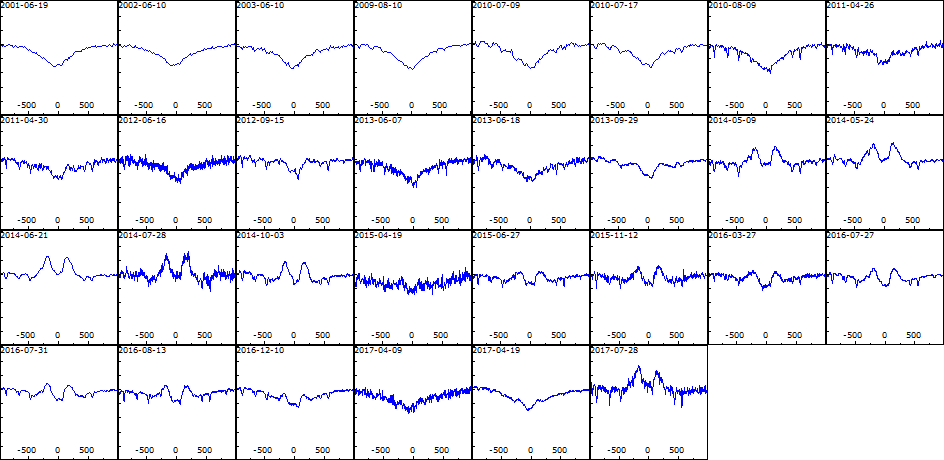

This is not the first outburst recorded in BeSS - see the time serie
V532 Lyr time serie.png (25.77 KiB) Viewed 3757 times
The semi quiet period lasted about 7 months. The stronger previous outburst was observed at least during 1 year and '4 months over 2014-2015 but there was a second one, less intense observed in june 2015 and ending dec 2016.
The emission was confirmed by me on the 31th of july.
