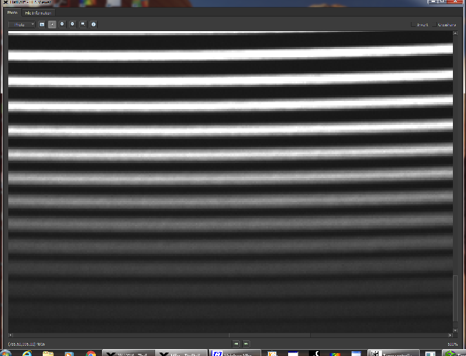

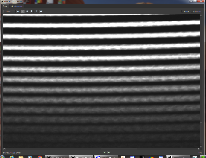

I know Christian has covered this before but the attached shows some flats I took without and with shaking the fibre optic cable to my echelle
Without movement
Without movement
With movement
With movement

Hi Andrew, this is a spectacular display of the modal phenomena in the optical fibers. A lot of ignored aspect by too many observers... The problem seem exist always at different degree, test similar to your experiment is a good idea for evaluation (and for tracking sources of pseudo-noise for max. SNR).
My eShel and VHIRES-MO fiber are always shaked.
Can you recall your setup Andrew: telescope aperture, diameter, type...
Very interesting !

Hi Christian, I have been commissioning a new telescope and echelle. The telescope is an Orion Optics (UK) ODK 16. It has a 400mm main mirror and works at F6.8. This is now mounted on a Paramount ME II using The Sky X to control it.
I use the Shelyak Fibre guide head with a 75 micron hole reduced for the 50 micron Fibre at F 4.5. The echelle is similar to the eShel in optical design but targeted at F4.0 and so has a bigger grating with a different spec. It gives R ~ 8000. I found I could not reduce the spectra using ISIS so have been on a journey to learn IRAF which once set up is no more complex that ISIS as you can run it via scripts.
I found the field of view of the guide head was too small for consistent plate solving (too few star or overwhelmed by a bright one) so I use an On Axis Guider to acquire the field before using the guide head to pull the target onto the hole and guide. Thus after opening the roof of the observatory I can run a Python program to control the mount and 3 CCD camera to get calibration and target frames for a list of targets.
I am experimenting with different designs of shaker as I need it enclosed otherwise it is too tempting for my Burmese cat!
