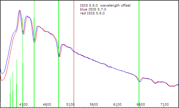

Has the way the dispersion equation is calculated changed in ISIS 5.9 ? I am getting a consistent +1 pixel wavelength calibration error when I calculate the dispersion equation from a spectrum and then apply it to the same spectrum. I did not see this with 5.7.
Re: possible dispersion calibration bug in ISIS 5.9.0?
It looks like the change in 5.9 to remove the bin 0/1 anomaly
http://www.astrosurf.com/buil/isis/new/release.html
has affected the way the dispersion equation is applied to other spectra
I am rolling back to 5.7 for now
Robin, the problem is fixed (I hope!). See V5.9.1 version:
http://www.spectro-aras.com/forum/viewt ... f=8&t=1854
