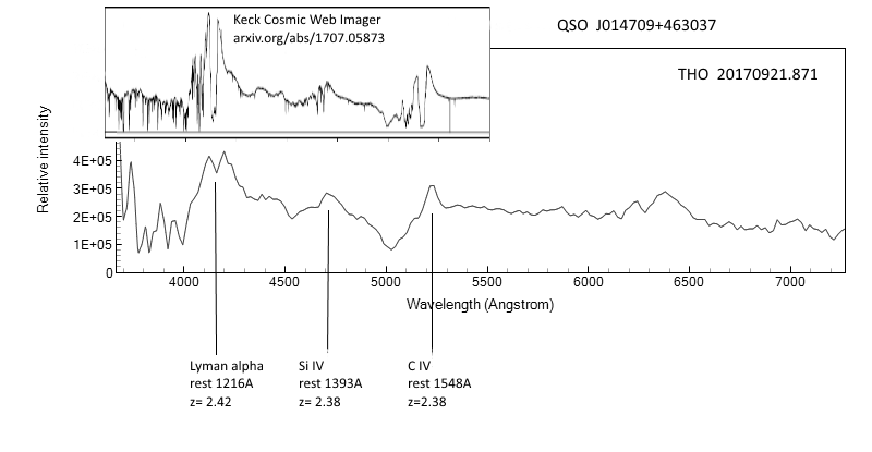

Just for fun, the recently discovered quadruple gravitationally lensed quasar J014709+463037 with the C11/ALPY200 spectrograph.
My spectrum with an overlay of the confirming spectrum from the Keck telescope published here
https://arxiv.org/abs/1707.05873
The broad UV emission lines from Lyman alpha, Si IV and C IV have been shifted at z =2.4 into the visible.

My spectrum also shows a broad emission line at 6390A which is not covered by the Keck spectrum. At z=2.377, this works out as 1892A rest wavelength. Does anyone know what that might be ?

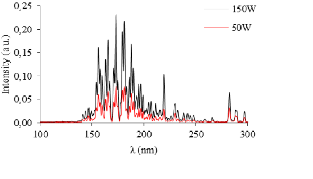

Hi Robin, how about oxygen? I found this https://www.researchgate.net/figure/287 ... -to-300-nm
Cr 2 has a line there but it does not seem a good candidate from an astrophysical perspective. Nice work getting the spectrum.

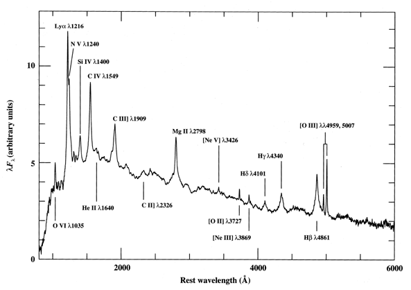

Having dug a little more and finding this "mean" QSO spectrum in the rest frame I am tending towards C III] at 1909A which would give z=2.35
https://ned.ipac.caltech.edu/level5/Glo ... uasar.html

Hi Robin, given the strong C IV peak then C III looks a strong candidate.
I assume the pros use a model to help them assign lines. With so many "metals" identified the number of possible lines is vast.

Yes the paper with the Keck spectrum is an interesting read. They used a quasar spectrum template to fit the main spectrum and determine the redshift. They then set about identifying groups of narrow metal absorption lines (not really visible in my low resolution spectrum) from the various intervening galaxies the light passed through at different redshifts, identifying 8 of them. From that they identified the 3 candidate lensing galaxies and built a model of the lensing system.From that they identified the likely lensing galaxy

Thanks for the prompt Robin, I have read the paper and it seems to be a real detective story.
I am not totally convinced about how you can confidently assign a given line to say C IV and then use it to estimate a given Z. You could have picked almost any other line and calculated a different Z? I guess it comes down to finding a consistent pattern in Z values for astro-physically relevant lines. Given who they are and it is peer reviewed I will bow to their better understanding.
Regards Andrew
